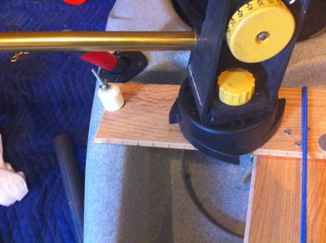

Here are the finishing touches.
The most permanent thing I did was to use velcro that had adhesives and put a few inches onto my kayak.  Other than that, no holes, nothing permanent.
It is ROCK solid.  I think it's going to work,  Now its up to the operator.
I used hooks to hold the two sides of the board down a la the cobra anchor build.  The board was too thin so I drilled a hole in the top of a PVC pipe cap and added a washer and wingnut for space.  The front is just wedged in and held in place by the bungie cords.  Screwed the two pieces of wood together and VOILA! I will say I had vision of breaking it down and assembling on water but no chance.  I'm just going to have to be careful about the weight of the downrigger slightly off to the side and high.
