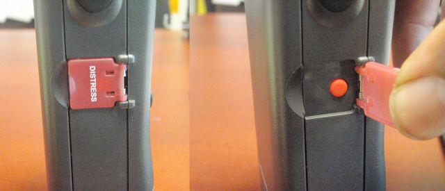

I talked with my instructor and showed him that it was downright difficult to set it off accidentally.
There is a small plastic door that fits almost flush with the side of the radio that covers the distress button. To activate the DSC distress signal,  you lift the cover, press and hold the button for 3 seconds, then the signal is sent and the radio beeps LOUDLY until it's acknowledged or canceled by me.
None of that happened.
He said all that he could think of was to go read the manual and see what else could set it off. The radio is supposed to be submersible to JIS 7 standards and floats. The inside of my hull was wet, but did not have any standing water. The manual didn't have anything to add.

Is it possible some sand or dirt got behind the button and some pressure on the red panel caused some flex and was enough to set it off?
While anything is possible, that seems rather unlikely.  Although the radio was inside the hull unsecured, it would be fairly challenging to have the cover fly open, have some sand jam in the button, then slam shut and hold it for at least 3 seconds (Their really is not that much sand in my hull) On top of that, I never heard any alert tone and that is a LOUD tone.
