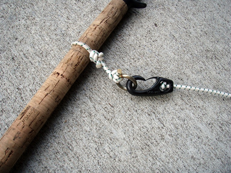

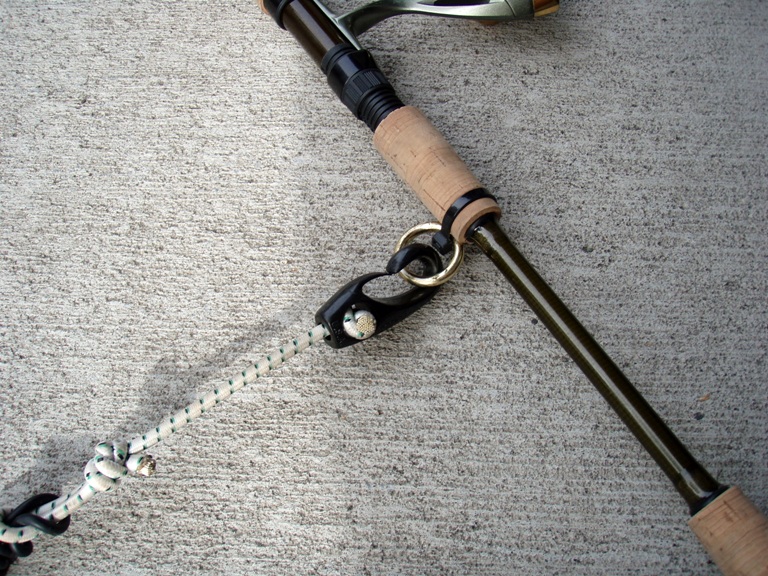

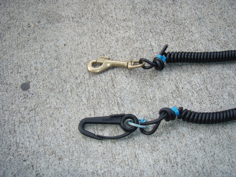

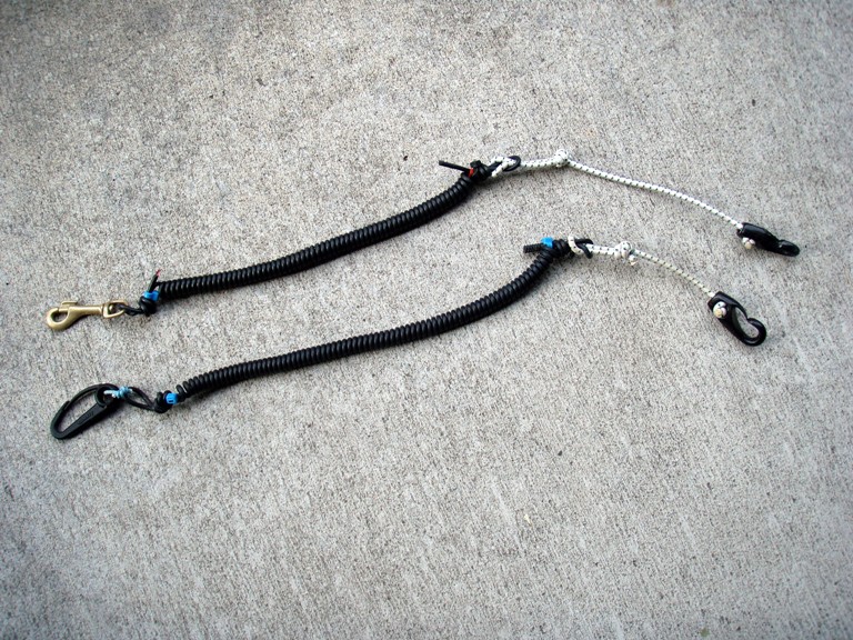

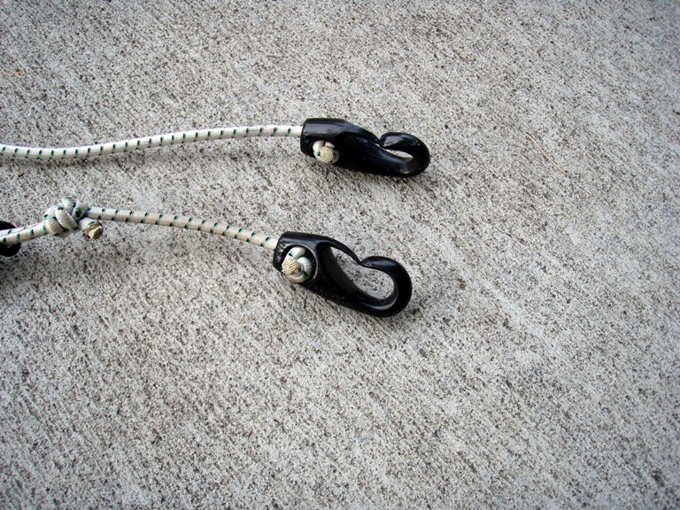

Here are the ones I've made - I'm really happy with them.  I've had them for around a year now, but I'm still tinkering with designs.  I like not using brass clips so I never have to rinse them off and the plastic clips aren't as noisy.  I haven't used the one pictured with the brass clip for a while because of this so I'll probably change it out soon.
I use velcro on my rod leashes too.  I got some 1" wide velco tape with hooks on one side and nap on the other.  Asked TLW to fold over an one end and sew it into a loop nap out.  Fed the cord through the loop and tied it off in a loose loop, and added a snap on the other end.  I wrap the velcro around the rod butt and feed it through the sewn loop.  It gives a full 360 degrees of velcro contact.
It's smooth so I can basically ignore it, and nothing is rattling around on the rod.
