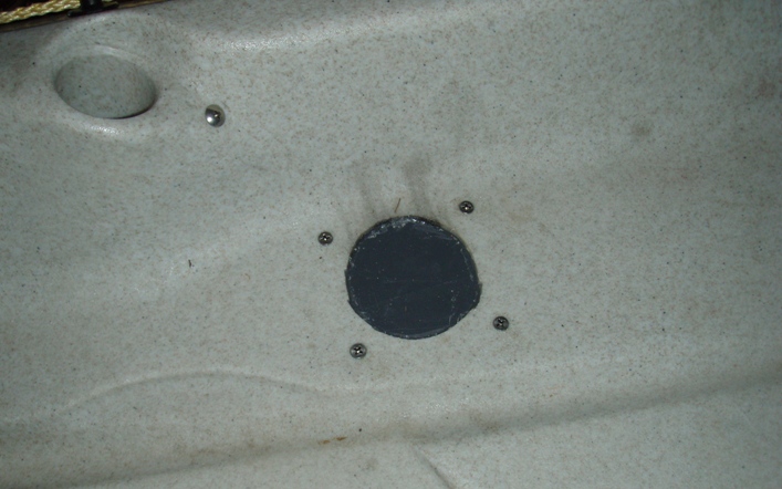

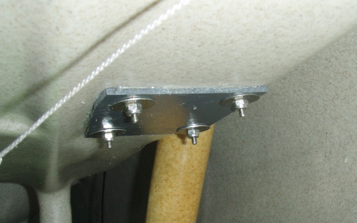

Here's the repair I've made to my Revo.  A sheet of schedule 80 PVC, stainless #8 bolts, nylock nuts, fender washers, and Goop.
What was going on here, that made such a big hole that needed repaired?
(See attachment)
Let's just say I was really good at installing it.  ::)  I'll go into more details when I update my Rigged Revo thread.
