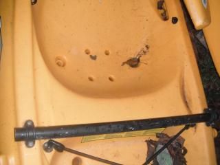

A guy over on the Hobie site has had them mounted just in front of the front hatch, which I'd think would interfer with fishing, just behind the seat, the most common but I'd think would interfer a bunch with paddling, and just in front of the rear hatch on his Revo13. He likes the last option and that's where I've decided to mount them also. I'm not familiar with that model Hobie in your picture though.  Just in front of the rear hatch for me would be the same as just behind the rear hatch for you...if that's your Revo we're talking about in the picture.
FWIW.....Unless I'm mssing something I can't mount the sidekicks immediately in front of the rear hatch (Revo 11 & 13) using supplied parts. The release button holes in the center shaft are nearly centered where the mounting brackets should go. Adjusting the holes in or out throws positioning waaaay off. I suppose I could cut a little off each side of the center shaft and drill new holes. That could get things weak and a little ugly for me to do it.
A piece of that prepainted pipe without holes would work for me. It's a 30mm od with a 1mm wall. I need to find a longer length of that that's used for something else I could buy from Hobie parts I suppose.

....or I can remove a small section from the middle of the center shaft and splice it with a 30mm id collar. That should work.
