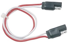

I bought a couple of these since shipping was free.
I just cut them to get two per package. These were the only other components I purchased separately for the project. I already had the tape, solder, and glue gun.
http://www.amazon.com/Hopkins-47965-2-Pole-Flat-Extension/dp/B0002Q80RW/ref=pd_sim_e_6
