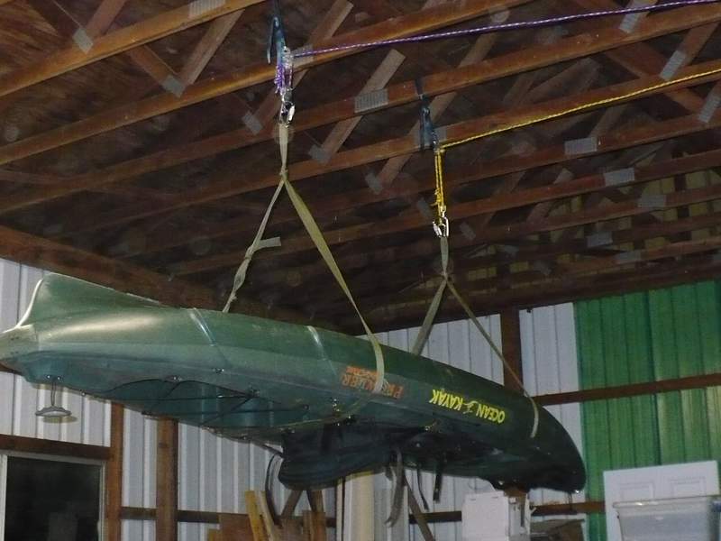

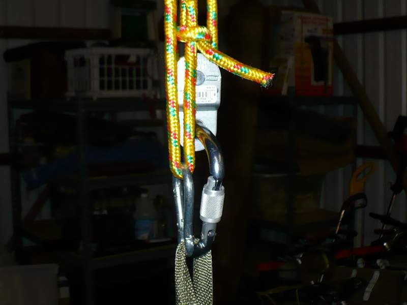

Well I finally put the lift system in the pole barn to get the Big Game out of the gravel and dirt. Overkill abounds with the hardware, but it's only money right? This system provides a 3:1 mechanical advantage and is easy to adjust. There are still a few slight changes to make it work better, but it works fine as is.

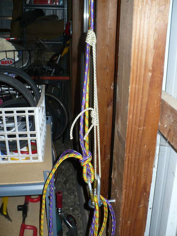

Here is the anchor system. Carabiners attached to the beam. The line weight held by a prussik and backed up with a loop knot.

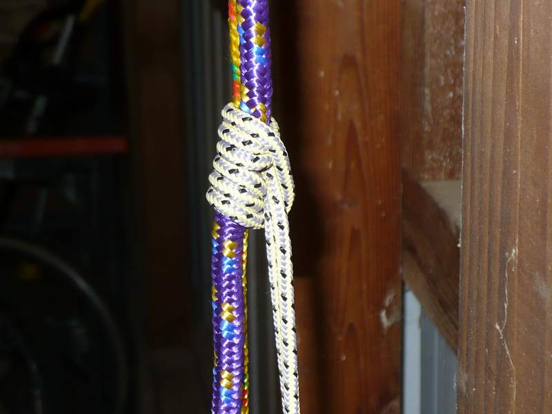

A close-up of the prussik.

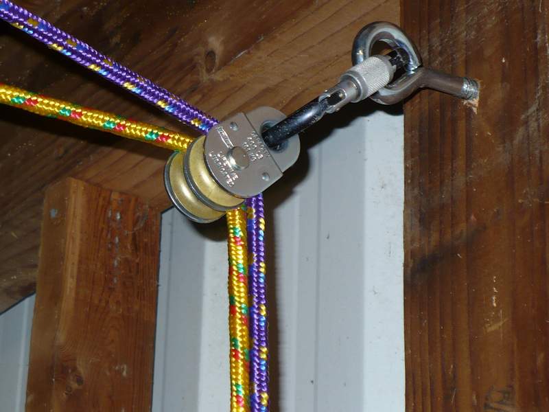

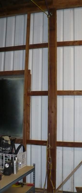

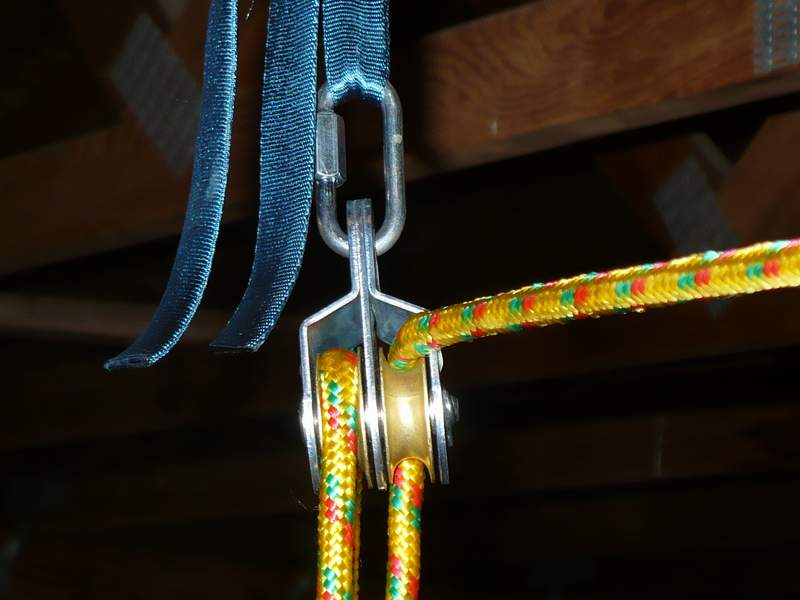

The line then goes up the wall to a double pulley to change the pull direction.
A close-up of the pulley.

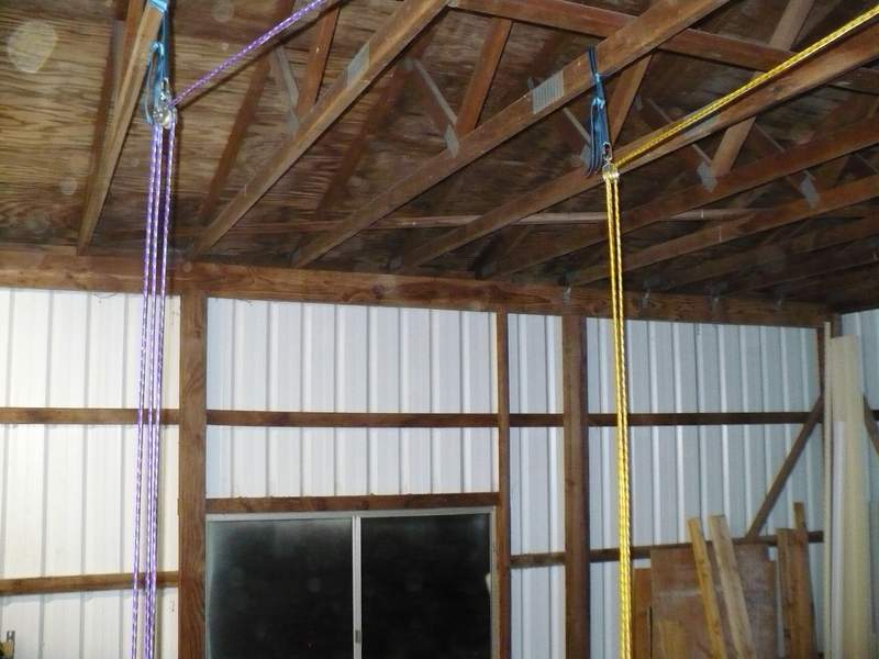

The lines then run to a double pulley for each line.
Here's a close-up of a double.
The lines then run down to a moveable single pulley, back up to the double and, finally, tied to the carabiner attached with the single to the kayak. This gives a nice 3:1 mechanical advantage.
This is how it looks with the kayak up about 7 feet off the dirt and gravel floor.
Not very difficult to do and many details could be done differently. I've over-engineered this system as a prototype for another hoist for the truck canopy next.
Jay
