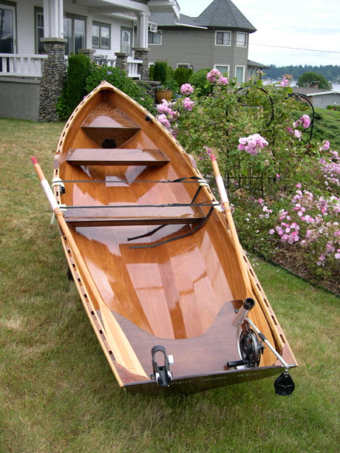

I've had a sea kayak since the 80's but my go-to boat in Puget Sound is my Pygmy Kayak kit "Wineglass Wherry".  It's an ultralight boat made with stitch and glue construction.  At a little over 100 LB I can carry the boat a few blocks by resting the center thwart on my shoulders.  Hull speed is 4 to 5 knots with oars.  I rigged it with FISH ON holders and a Big Jon "Big Water" manual downrigger.  I put a hauling cleat amidships and on the bow for handling anchors and pots.  I use a Hummingbird portable downrigger kit with a DIY transducer bracket that allows me to attach or retrieve the transducer without damage when beach launching.
What I like best about this boat is I can cartop and launch the boat on my own and it's a dream for slow trolling and mooching. It's well mannered in sloppy water and wakes.  And I can handle full-sized crab and shrimp pots from it.
What I like least about the boat is how much wind effects it.  It is a kite in a breeze and it's very difficult to make headway against a wind stiff enough to blow up some chop.

Woo Hoo!!  So the Big John downrigger was selected as the smallest/lightest available that could spool 200+ feet, mount to the thick wood of the aft thwart and have the arm clear the stern.  A 9 pound ball is well behaved on the J-arm which dampens bob very well.  BUT the downrigger has proven to be a pain to fuss with, I do better direct weighting the line and mounting the rod in a holder forward of of the port oarlock.  I can row, adjust my rod, let out line, watch the rod tip, all from the center thwart.  I bungee the Hummingbird on the starboard side of the center thwart so the rod is to my right and I can glance left to monitor the flasher.

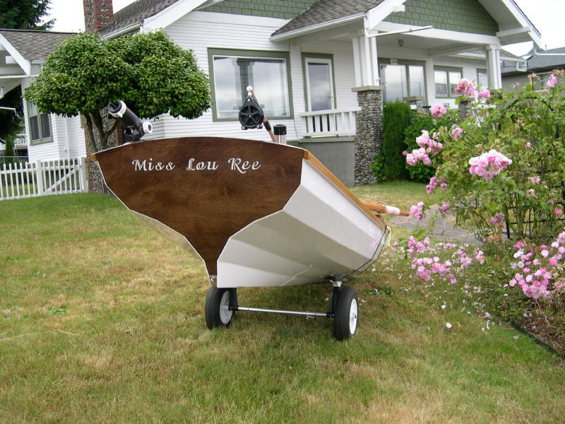

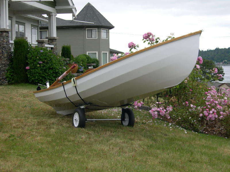

And so you see the "Wine Glass".  I purchased the carrier from Pygmy, as well, and the wheel-barrow sized balloon tires let me negotiate some pretty big obstacles.
The steep, high entry defends the bow when pushing into rough water.  BUT, as I said, the boat catches the wind and making headway in a strong breeze is tough.
I've powered the boat with a 40LB minn kota and it reaches hull speed (4-5 knots) at 3/4 throttle.  Unless the wind is cooperating some kind of power is needed to use the downrigger.  But its a lot less bother to leave the motor behind and just row, using banana weights or a dipsy to get down.  This weekend I hope to try a Honda 2.3 which has the only shaft tall enough for the 20" transom and weighs only 30 pounds, 1/2 the weight of my group 27 battery.
