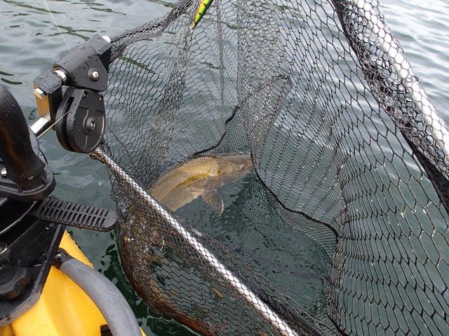

Here’s a picture of a good-sized bull trout I caught last weekend with the downrigger.  I returned its endangered butt to the lake as soon as I took the picture.
