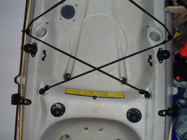

As you can see I have 4 RAM balls behind my seat.  The two positioned just behind my seat are mounted with rivets since when I use them for a rod holder they do not see a strong rotational force.  The two that are just forward of the molded rod holders are mounted with bolts and large washers on the inside for backing support.  It is possible for these to experience a decent amount of rotational force because of how I use my RAM Revolution rod holders on them so I felt that rivets wouldn't cut it.  They are positioned just far enough from the seat that I could barely reach the bolts to thread on the nuts by reaching in from the back hatch.
