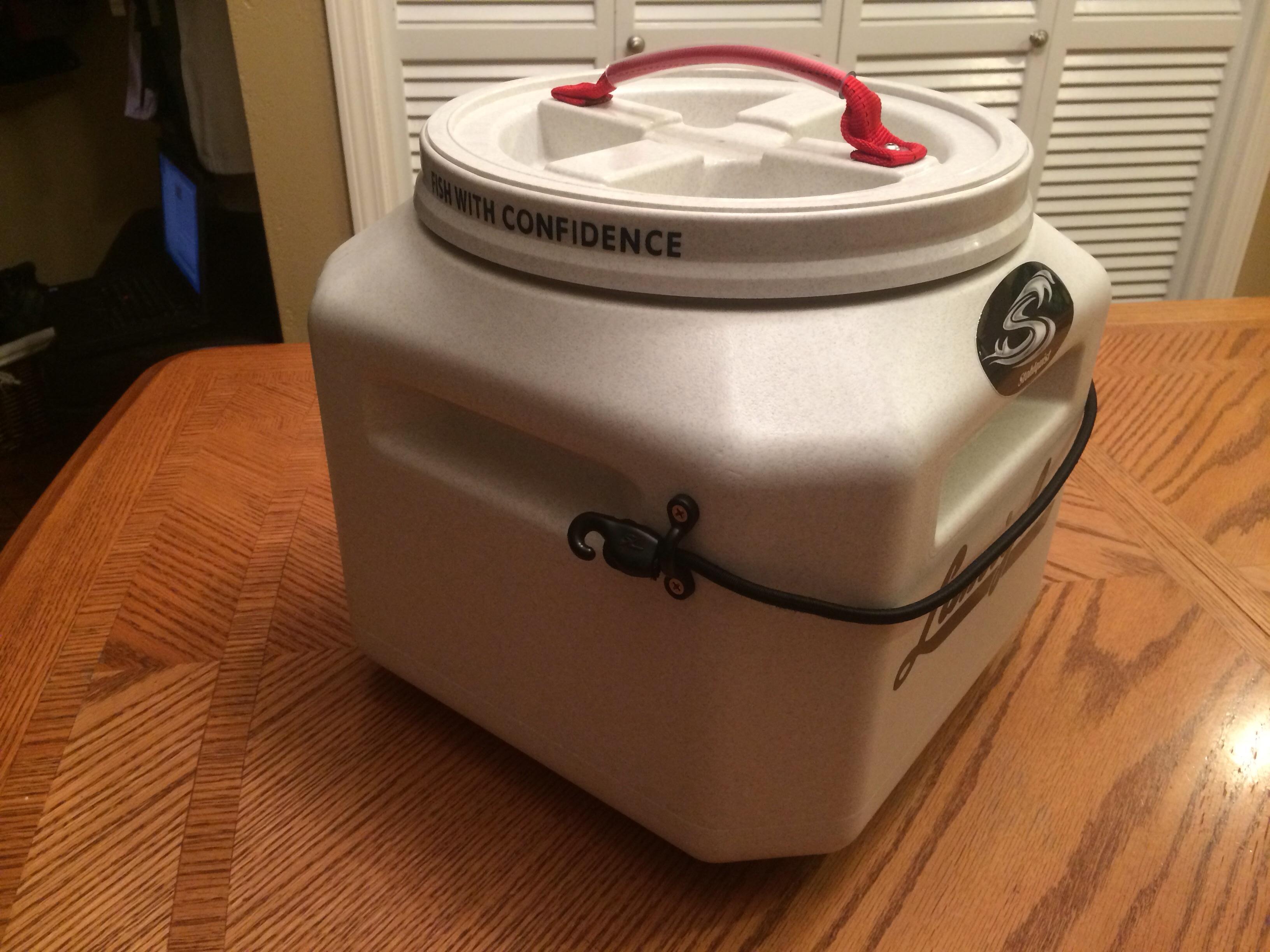

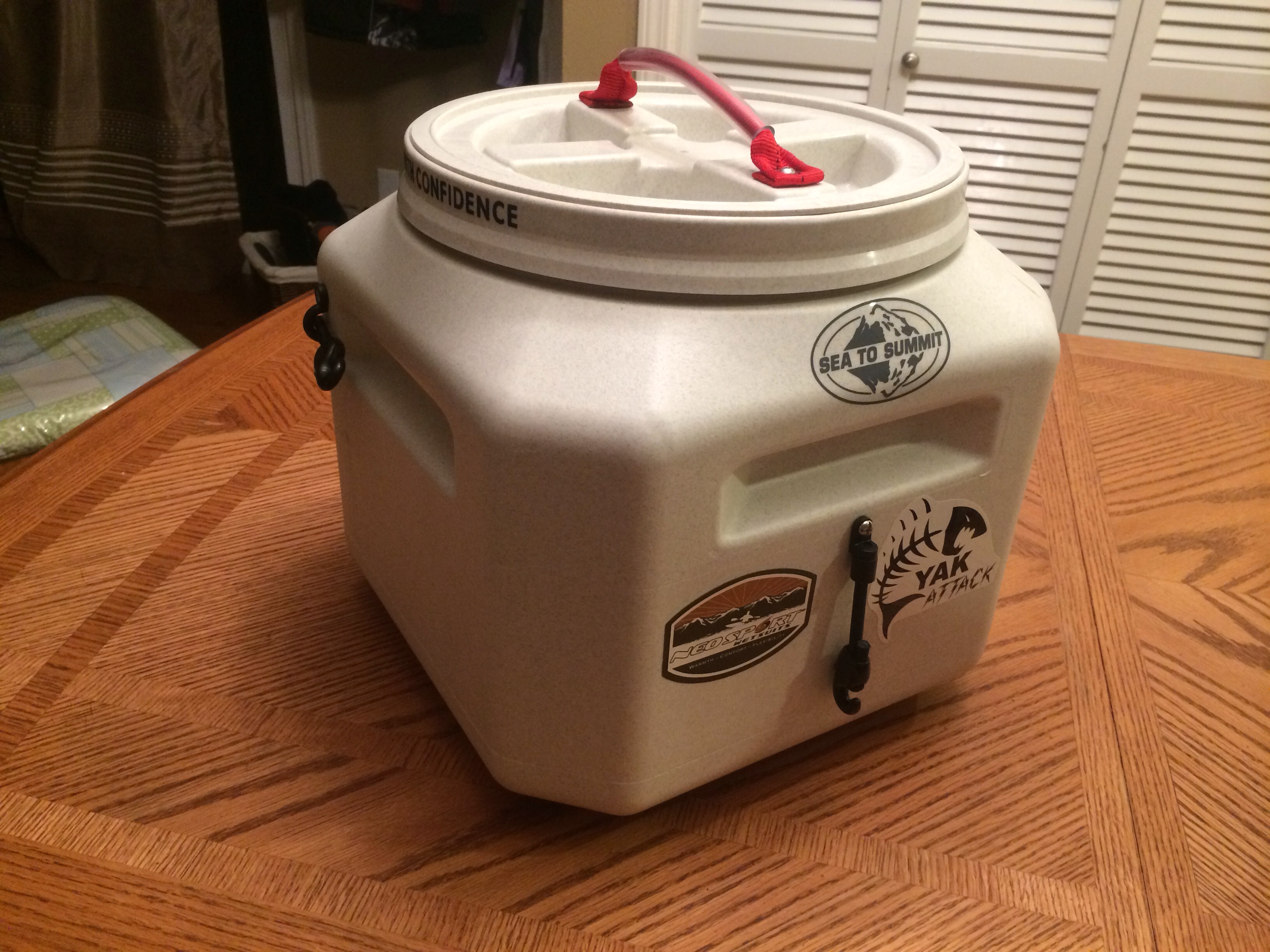

I've had a bunch of positive comments on my dog food tacklebox.  So here are a couple pics:
This is made with a Vittle Vault by Gamma. Check around your local ranch supply and pet stores to find the size that works best for you. I believe I spent around $30 for the bin and most of the other parts I already had from other projects. (nylon webbing, stainless hardwear, padeyes) There are many other links on the web about using these and Pelagic on here has a good write up about one he built as well.
Not seen on the pic is inside I have some basic loops to organize some of the smaller gear and a tether to keep from losing the lid. Soon to come is a holder for my bonker and another for my fish grips that I just need to install. It'd also be great to mount a track/rail or camera boom along the top ridge.
I've found is that it does a great job of keeping the salt off of gear. (Once something gets salty, do not put it back in the box.) However, I won't take it on all of my outings since I just don't need that much stuff all the time. Which is why I want to make another smaller one.  :D

how "water tight" is it after you start poking holes in it?  Are you using goop or anything?
The lid has a gasket and I have not experienced any leaking from the holes I've put into it.
seems like the extra buoyancy would keep your kayak from rolling all of the way over (if it's closed) but be might be really hard to flip your yak if it's open and fills with water.
I haven't found any issues with the kayak rolling. Just take your eyes off the surf for a minute and you'll roll right over. ;)  luckily it rolls right back over just as easily.  I haven't yet rolled with it open, so it's hard to say. I'm guessing if you had a bunch of rods strapped to it vertically, that would change things more than just having it open.

Skidplate, how wide is the mouth.looks deceiving on my phone.some of those vertical screw on 3 rod holders with some industrial Velcro around the sides couldmake it very modular.
Without putting a tape on it, I'd guess the inner diameter to be around 12". Let me know if you want an actual. If you wanted to screw rod holders onto it that would work as well with good backing. It's rotomolded just like most of our kayaks.
