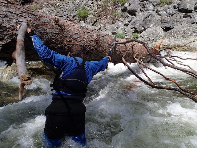

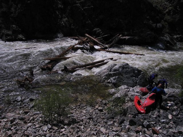

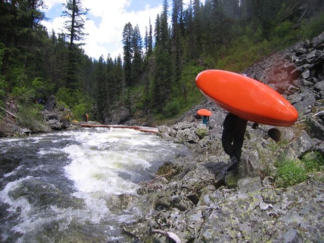

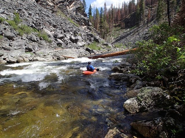

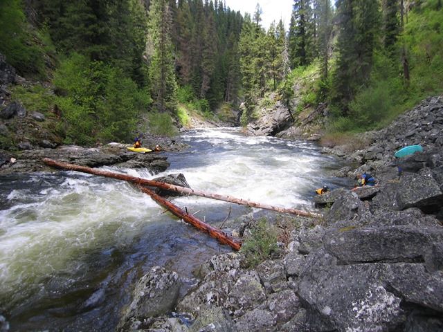

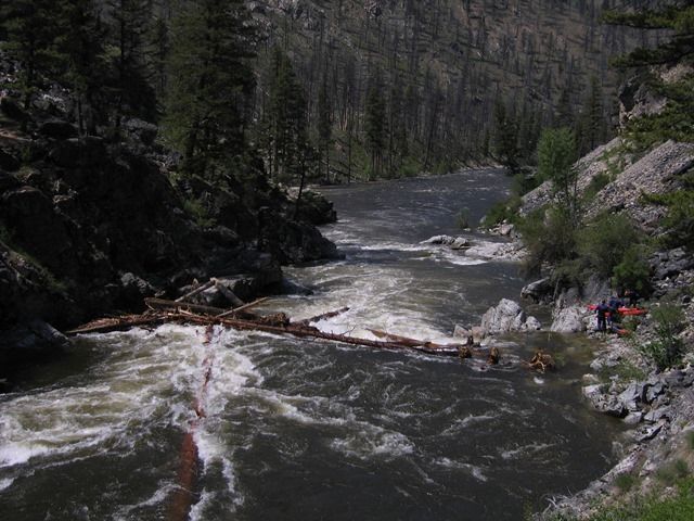

When whitewater kayaking, I always carry a small folding saw, and I've used it frequently to deal with wood and sweepers on rivers.  So if you are kayak fishing on moving water, consider adding a folding saw to your emergency gear.  It doesn't need to be on your life vest, but it's a useful tool to carry in your kayak.  The pictures below are from whitewater rivers and creeks, but fishermen and other recreational floaters regularly get tangled up in sweepers and log jams on flat or Class II rivers.
Sawing a route under a strainer log on White Sands Creek in Idaho with a folding saw.
But some log jams are a bit too big for a little folding saw, and you need to walk around them.  Here’s a bigger log jam on White Sands Creek:
Logs on the Little North Fork of the Clearwater in Idaho.  A kayaker has just run under the log, and his helmet is visible as he dives the hole below it.

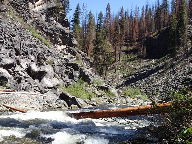

Log jam at Pistol Creek on the Middle Fork of the Salmon River in Idaho.
Wallys Wallow on the Jarbidge River in Idaho.
