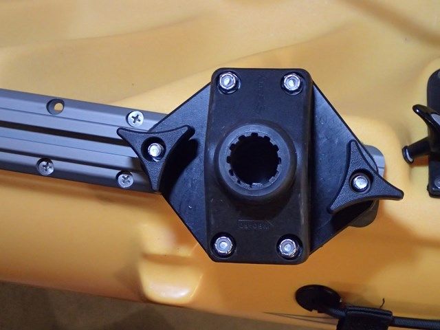

I also had problems with Scotty Gearhead mounts twisting in my Geartracks from the tension of my line while trolling, so I made a mount for a Scotty deck mount which won't twist under tension.
For details, see my posting about "How to make your own devices which mount on gear tracks" at http://www.northwestkayakanglers.com/index.php?topic=13167.0 .

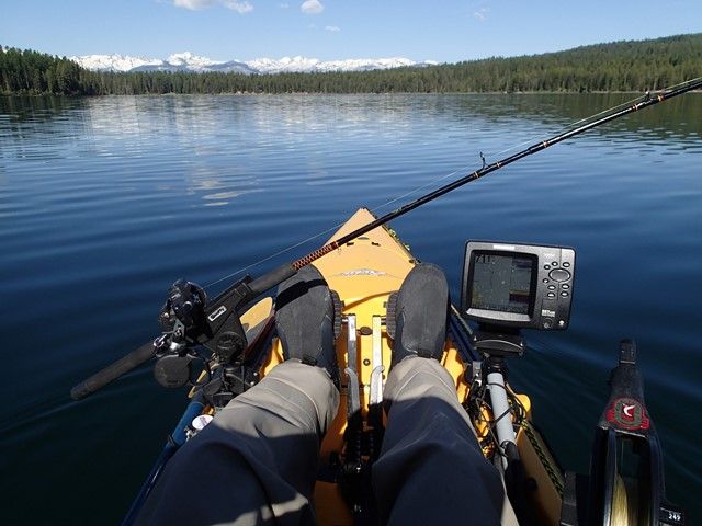

I had a similar issues when trolling for salmon.  My solution is bulky, but has worked for me.  I have a scotty push button lock base mounted to mighty mounts, or something close to that name.  The mighty mounts are mounted to a gear track, I personally used the wider unit for my trolling mount.   I have the scotty extended arm with the slip washers, and quick detach for the rod holder.  This mess of parts is bulky and not refined looking, but it hasn't failed while trolling yet.  On my kayak the holder is on the  right, and the rod tip is off to the left side when trolling.  The rod is high enough it doesn't interfere with pedaling.
The reasons I made my own base for the Scotty deck mount rather than using Mighty Mounts are as follows:
1.  So I could position the deck mount as far back as possible on my left gear track, (a) so my left toe doesn't hit my rod when I'm pedaling, (b) so I don't need to raise up my rod holder on an extender, and (c) so I can easily crank up my fishing line at the same time that I crank up my downrigger weight.  Mighty Mounts take up more space on the gear track, and would have required that the deck mount be oriented in the same direction as the gear track, both of which would have resulted in my rod holder being located further forward than I prefer.
2. So I could position the deck mount so my rod is at right angles to the centerline of my kayak, rather than at right angles to the gear track.  If I used Mighty Mounts, the deck mount would have to be oriented in the same direction as the gear track.
I'm thinking about replacing the standard deck mount with a locking deck mount like the one which you use, so I don't need to worry about the rod holder coming out of the deck mount.
« Last Edit: June 23, 2014, 01:20:48 PM by pmmpete »
I agree with Fugitive's suggestion.  Since you mentioned you have the tracks just get some Mighty Mounts and be done with it.  I've trolled with well over 12 oz. with this setup and it is totally solid.  The addition of the slip discs makes it really easy to adjust.
