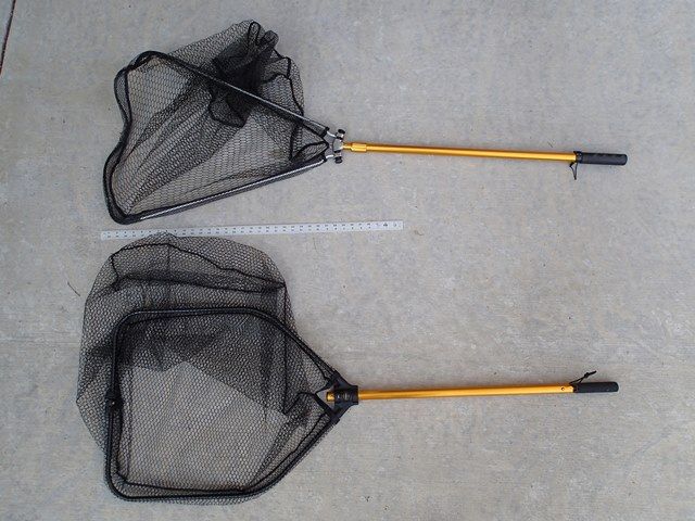

Many kayakers fish with a big long net sticking way above their head from a rod holder.  I don’t like doing that.  When stored in that manner, big long nets catch wind and reduce the stability of a kayak.  When fishing for big fish, I like to use folding nets.  I’m writing to compare two folding nets which I’ve used.  On the left is a Frabill Power Stow net, and on the right is an Uncle Josh Quick Fold Net.  Frabill makes a folding net which folds somewhat like the Uncle Josh net, but I haven’t seen or used one of those nets.
Here the nets are open.  The handle on each of these nets extends to almost twice the length shown below.  Both of these nets have rubberized mesh, which I like because it reduces the amount of time I spend extracting lures from my net.

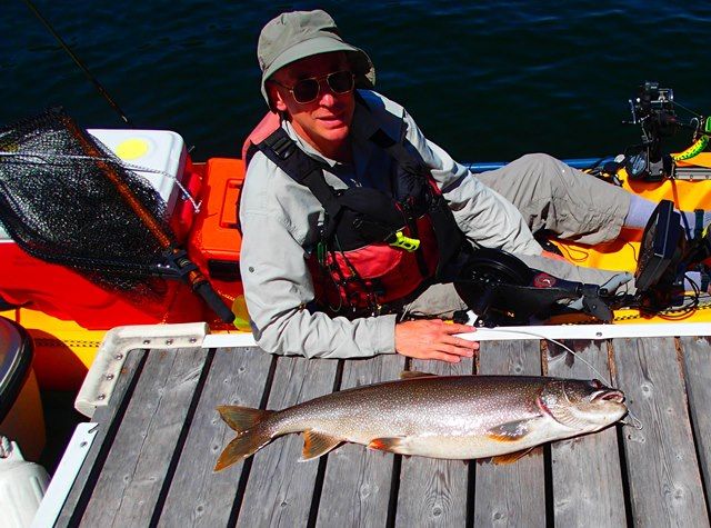

I leash my net so I won’t lose it, and bungie it on the back of my kayak where I can grab it easily, as shown below.

The Uncle Josh net is easier to deploy than the Frabill net.  You just hang onto the handle and let the net flop out and lock in place.  To open the Frabill net, you need to first open up the rim of the net, and then slide the net out to the end of the handle.  It’s a more complicated process, but I can do it fine with the help of a toe, or by hooking the rim on my downrigger.  I haven’t been extending the handle on either net, as I don’t feel that I need a longer net.

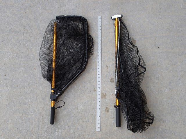

The Uncle Josh net is quite compact when folded, but a disadvantage of this net is that it’s kind of floppy and fragile.  I have bent the arms on the side of the net when wrestling with a big fish, and the flexible support on the end of the net sometimes comes off the end of the arms.  The Frabill net takes up more room when folded, but it’s sturdier, and overall I like it quite a bit better than the Uncle Josh net.

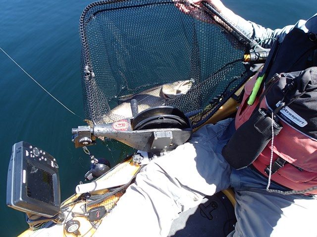

Here's the Frabill net in action.

The idea of a folding net is great. I hate nets and never carry one unless I'm live baiting for big lings or salmon fishing. What's the largest fish you have landed in a folding net? I just don't think I'd trust one with a lively king or even a big coho.
Thanks for the write up.
I haven't ever fished for salmon, but I've landed a lot of lake trout in the 30"-36" range.  The lake trout on the dock in my posting was 34.5 inches.  Lake trout can be pretty feisty, but both of these nets handle them fine.
