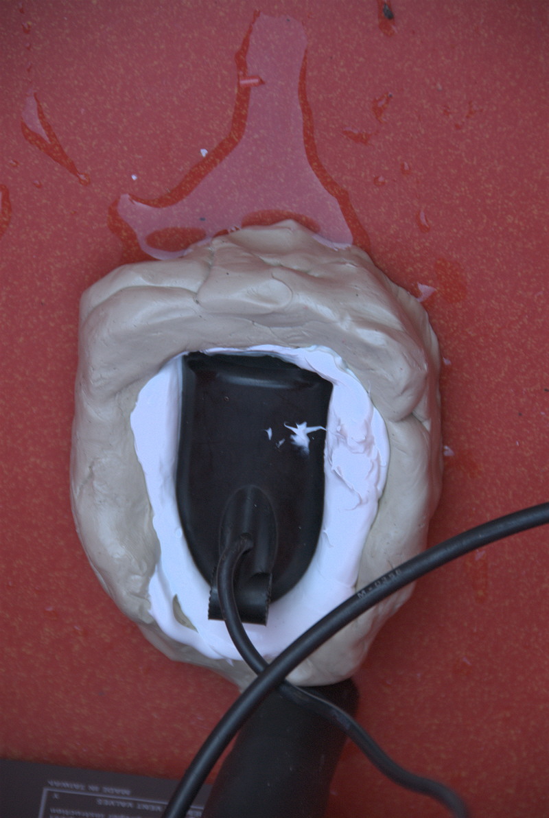

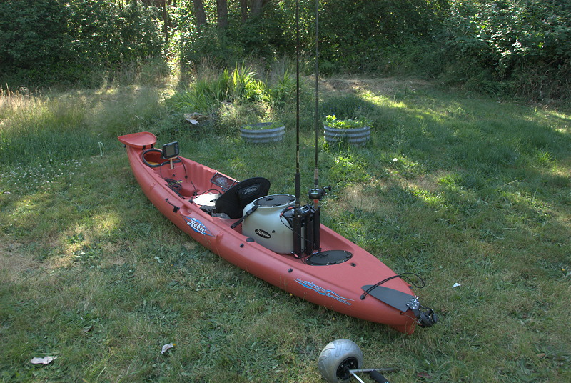

Finally got some time after having company over the 4th till yesterday----made a dowel adapter and installed the Lowrance X-85 into the mast hole, here's the Revo sitting in the yard:

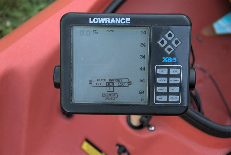

and the fish "finder", you can see the dowel stuck in the masthole.
I made a well from Plumber's putty, then splorped about 2 ounces of silicone into it and plunked the transducer in, it took overnight to cure.

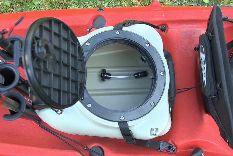

Here's Hobie's expensive (I was overcome by gear lust, Dan offered and I couldn't refuse) livewell, the intake tube sticks down thru the scupper hole, it's just lying in there, waiting to get into the water!  Plan is to go down to Point Robinson after "work" today... and see if I can scratch up a king or 2. The migratory kings are slow coming in, a friend got 2 yesterday (12# and 15#) after being skunked the last couple trips.  I pulled in a 15# last Thurs on west side of Vashon, but it had an adipose fin....so is still swimming.
Nice looking ride K! That's a real salmon slayer. So how do you like it?

BTW what do you use the bait tank for?
Looks really good. where did you run the cable through the hull for the transducer?

But I'm a little concerned about your transducer. Did you squash it down to the hull or is it "floating" on the silicone? If its floating, it may give you some wonky readings and you may want to remount it. In any event you want to make sure its thoroughly cured or the transducer might make bubbles in the silicon.  I don't mean to send you into a panic, so you should try it on the water first. It may work great and read fine, but if not,,,.
Actually, its really not a big thing and you could mount it dry with a foam wedge.
Also that's a sweeet bait tank! But does Washington allow live bait?

I don't know about Washington, but in Oregon live bait is a no-no on freshwater, but I think out in the ocean it's okay.  Bust out the sabiki and catch a few herring or anchovies on your way out to the fishing grounds.   Personally I like using a bait tube, much easier to deal with on a kayak.

Thanks for the headsup, Tupperware---I mashed the 'ducer down to the hull, but have not tried it yet.  Am chomping at the bit....as for live herring, I dunno.  Fishing in the Arima, we jig them from the Sound, or buy them live at the Point Defiance Boat house, and keep them alive in one of those floating gizmos, or in a bucket in the boat and they slowly perish./  We mostly plug-cut them, but sometimes send one down hooked under the dorsal fin....Before I had an Arima 15', I had a 14 foot Livingston named "Sick Leave".  You can never have too many boats!!!

   Zee, when I mooch, I like live bait, even if I have to plug-cut it----the fresh stuff is slimier and catches more fish than frozen.  Also, the rodholders are handy, and if I am trolling hardware, I can dump a load of stuff in the livewell for dry storage!  Will post the hardware I use in a separate message, took some pix this AM.

Tupperware----went out last nite, the FF worked great.  Good signal, the downside was---no fish! Saw a couple clusters of herring but no salmon arches, getting a little worried that the run this year is so late.

A note on the Revo----the rodholders are behind the seat, I don't like them---plan to mount at least one Ram/Scotty on the starboard gunnel, up in front of the pedal drive.  Need to see what's going on, and have the rod easy to grab.  I used a little (size 000) Deep Six diver and a cone-type flasher last nite, a PITA with the rod well behind the seat.

You know I was going to mount one on my big A too but recently have been trollling holding the rod in my right hand with the rodbutt tucked into my pfd. I know it sounds pretty crazy but it's awesome to feel every little bump on the lure and setting the hook can't be faster or easier. It might be difficult since the Deep Six puts up a lot of resistance but maybe give it a shot just to see what it's like. I like it so far since it makes trolling more exciting.

EXCELLENT! Glad it worked out for you and that looks like a really solid installation. Forget the fish arches as I have caught a lot of fish that "were not there" ;D as long as the bottom reads well. Did you try the livewell? How's it paddle (pedal) with that chunk of water out back?
To be honest, I have never really liked rear mounted rod holders. They are okay for storage, but I prefer to have my rod at hand and in sight while trolling.
I used scotty flush mounts just out of paddle reach on both gunnels on my Hobie Big A. It needs the extension to get the rod butt out of the way, and you really only need one as you can rotate the rod holder to fish either side. (unless your using the other one as a downrigger)
