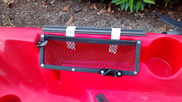

Fore cockpit, starboard side:
No challenges here. Before drilling I re-positioned it slightly to be centered on the gear pocket. This is a 12-inch GT90.

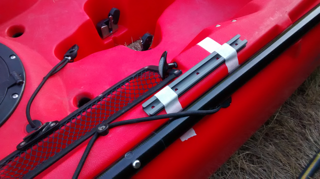

Fore cockpit, port side:
The paddle for the fore position is stowed on this side, and its blade gets in the way of a more forward install. By putting an 8-inch track here I still get some usable mounting space at about the right distance from the seat.

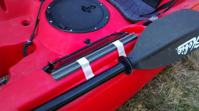

Aft cockpit, starboard side:
Here the retention bungee and related hardware for the aft paddle gets in the way of putting a 12-inch track by the gear pocket. I decided I liked having the 8-inch a bit farther away from the seat in this case. You could also just pull the bungee over the track, but I felt this would interfere with use of the track and I liked this solution better.

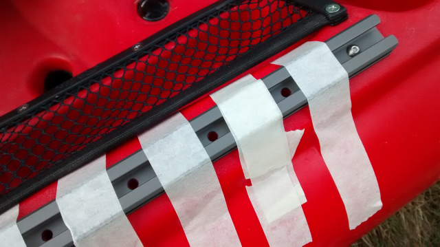

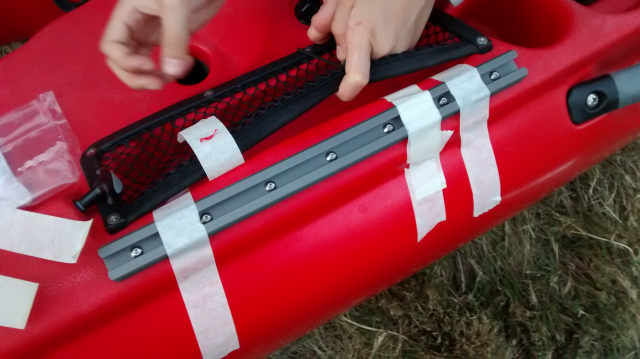

For the next step, I finely positioned the track and applied tape tightly across the track in as many places as possible. Using the recommended method, I drilled through the first track hole, dropped a screw in the resulting hole, and proceeded to drill the remaining holes.

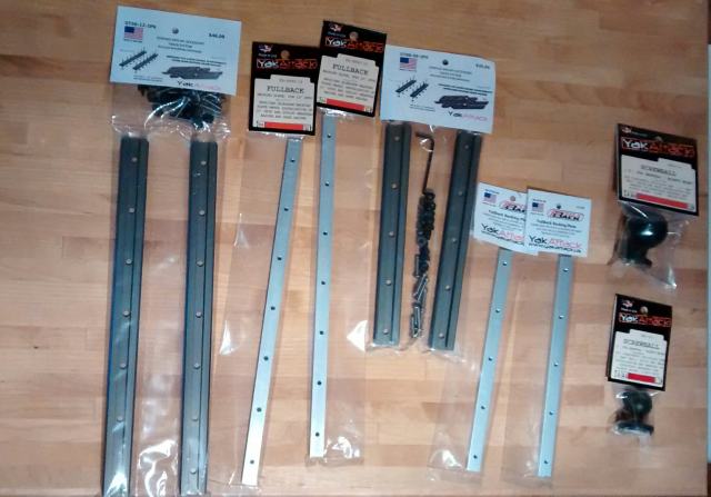

Due to the tight internal spacing of the gunwales (especially in the front cockpit), and for ease of installation, I sprang for the YakAttack Fullbacks, which are pre-drilled/threaded backing plates. This greatly eased the labor of getting the screws in place and I was able to install all four tracks inside of a couple of hours. In some cases it helps to have a 10-year old set of hands helping get up inside the gunwale.  ;D
The screws fit so precisely into the Fullbacks that I doubt any water could ever find its way in. Regardless, I put a small dab of marine RTV sealant in each screw hole before proceeding.

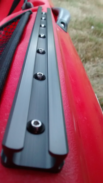

A fresh aluminum track installed correctly looks pretty sweet.

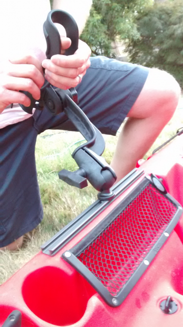

First thing after tightening the screws I fitted one of my RAM rod holders to the new track with a 1.5-inch Screwball. It goes on as well as expected and the position looks great.

Nice work. I noticed the position of you rod holder. I mounted my track similarly and youll probably turn the rod holder so the rod crosses over your legs and points off the opposite side of the kayak. Otherwise the rod handle interferes with the legs when pedaling the mirage drive. Not a problem with a fly rod but certainly is with a bait caster. Have fun.
Yes, definitely. Some others on the board have mentioned that as well. A little less ruddering required that way to maintain a true path as well I assume.

Let me know how that screwball works. With the left-hand tension of the rod trolling will want to unscrew the ball?
<Proverbs>
I've read both sides of that argument and talked to several people who run them. You'll notice on the YakAttack site they label those for use with "light and medium-duty" situations. They recommend the spline-mount base on the GearTrac (two points of contact with the track) for "heavy" applications.
I will see how it goes and report back. I'm not too concerned for trout/kokanee/etc. I'm sure with bigger fish it could be an issue depending on your setup.
Also there's this, if you want to use your ball-mount but not worry about the "unscrewing" effect: http://www.yakattack.us/TBK_1005_p/tbk-1005.htm
