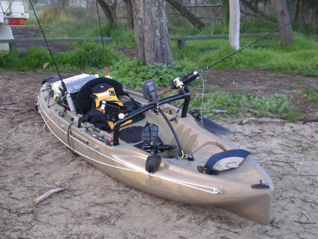

this is my solution to a no drill hobie RAM rod rack.  I use 1.25 inch pvc, it slids perfectly in to the rod holders already on the kayak.
Call me FIL THE CHUB MASTER!
