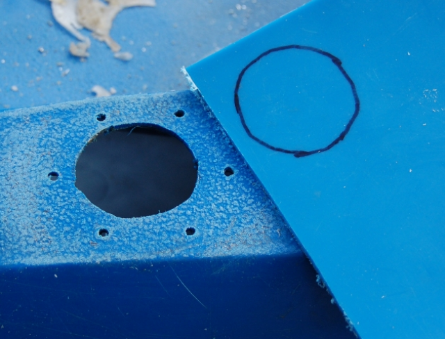

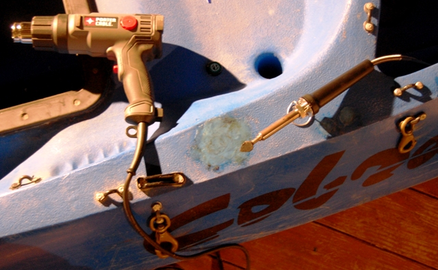

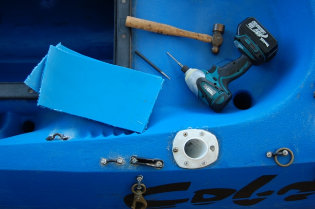

Pete - You rock!  :headbang: Th plastic you sent me worked perfect. Those of you that want to give this a try, make sure you use the same kind of plastic for welding that your yak is made of. I used a small piece of blue plastic of unknown origin & discovered it had a slightly different melting temp & viscosity which makes for a poor weld. The plastic Pete sent me was super linear polyethylene - same as my Cobra & it worked great. Melted together just right. Here's some pics. Did some GoPro footage, but haven't looked at it yet.

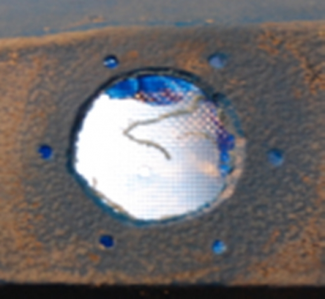

Backed the hole w/ stainless steel screen, welded to the inside. That was tricky. (lousy picture)
Not pretty, but solid & effective.
