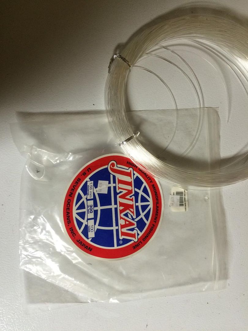

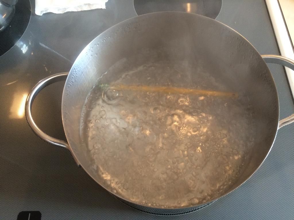

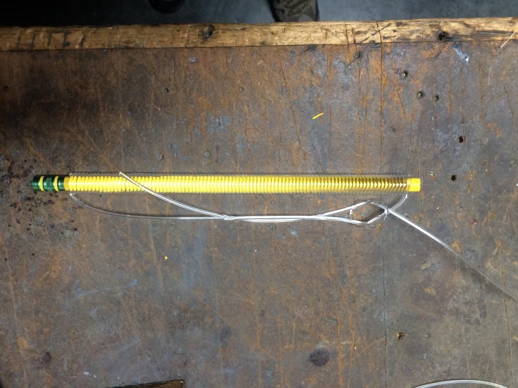

I saw another thread on here about building some tethers, and gave it a whirl.
Didn't have any of the weed eater cord used by the original poster of the thread, so I used 300# mono.
Drilled a couple holes in the ends of a pencil, wrapped the mono tight around the pencil, then tied the loose ends together.
Boiled the pencil/mono for 15 minutes, then cooled it in ice water for 10.
Unwrapped the mono, and crimped the ends into loops.  Probably snap a couple of carabiners on to finish it up.
It's about 6-1/2' long all stretched out, and about a foot long coiled.   I've no idea how long the mono will hold its coil shape, but it's a dirt cheap tether.
