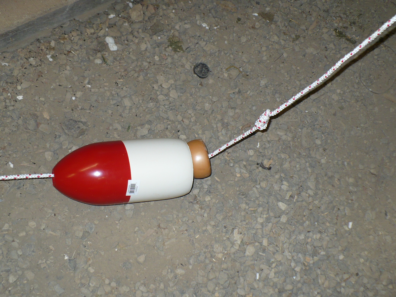

From the trolley, I ran a line to float the spool in case a quick release was needed. This line clips through the spool and onto the anchor line.

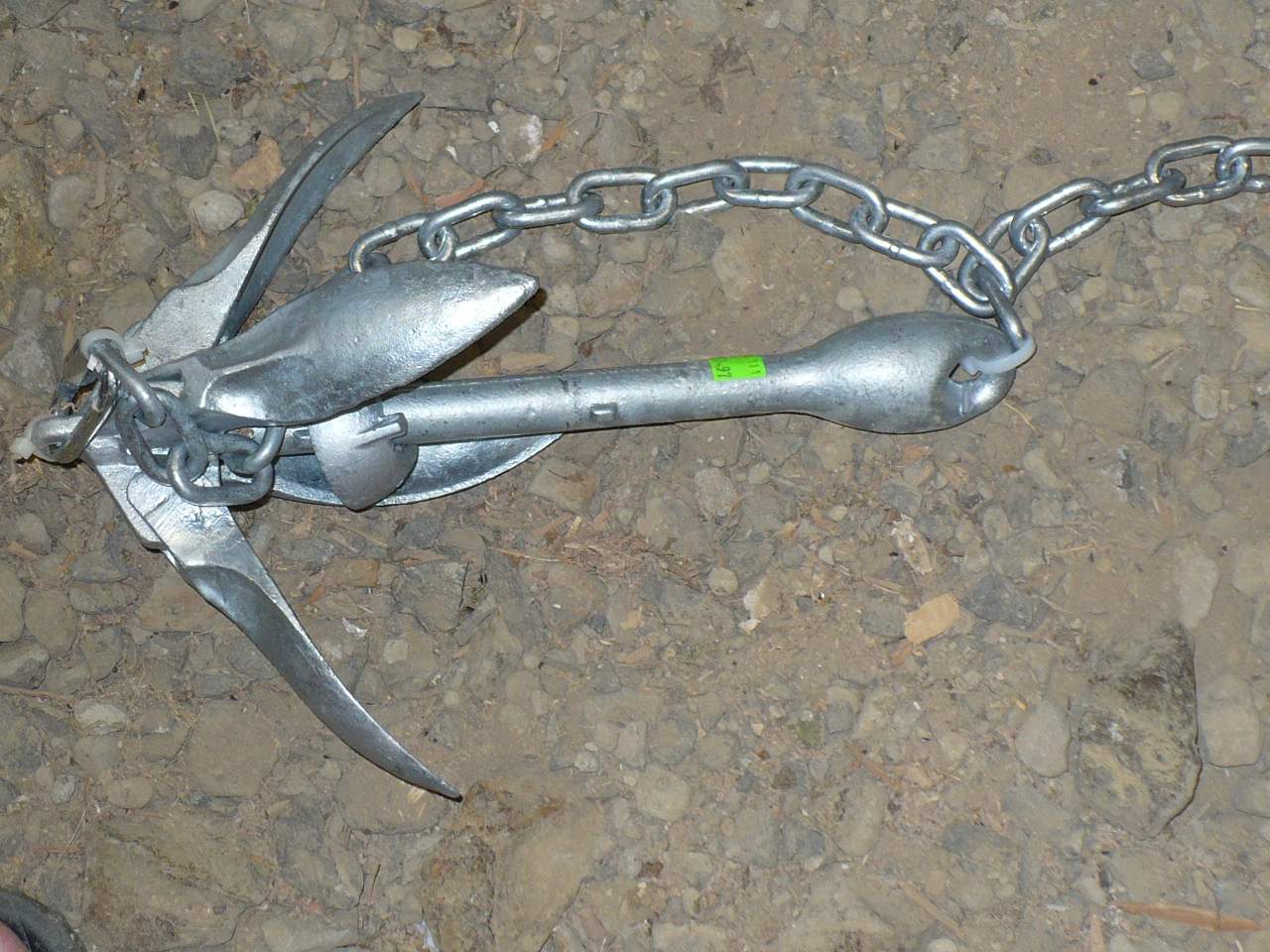

The line then runs out to a 3lb folding anchor with 2' of 3/16 chain. The chain attaches at the top of the anchor via a zip tie that will break on a hard pull, hopefully freeing a stuck anchor from the bottom.

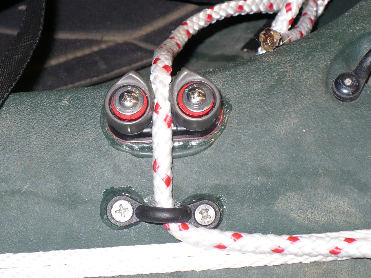

To keep control of the anchor system, and to provide a quick release, just in case, I installed a cam cleat to keep the line at my hip and released instantly. To keep the line perpendicular to the cleat, and to minimize the chances of anything lifting the line out of the cleat, I installed a padeye just below the cleat as well. These were the only 4 holes drilled in the yak and well sealed with goop.
