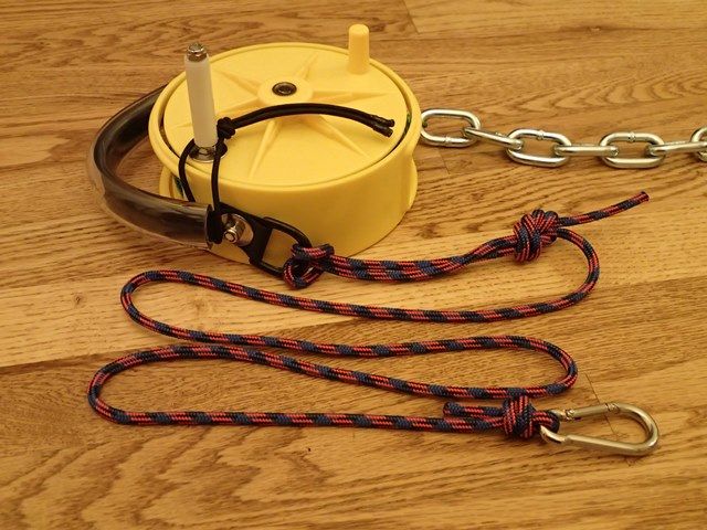

Here is the set up that Pete based his anchor system on. I have used it for 3 years and have anchored up to four kayaks in heavy current. You will notice the simplicity of using the belt loops for attaching the bouy and tie off line. As I have said three years and no problems. I like to have certain weak spots that will break before I tombstone.
As for reeling up your anchor. It can be done. I use a 6 pound jello mold anchor and find it tedious to reel it in. I usually pull up the anchor and then reel in the excess line. As for the pin, it too is designed to fail in a bad situation. To break the plastic around the pin takes about my body weight, 180#. It is very close to the limit on the leader I use for the anchor line.
I have been in a Kayak that started to tombstone. I would much rather have my anchor system systmatically fail before I am presented with that scenario again.
I hope this answers any questions.

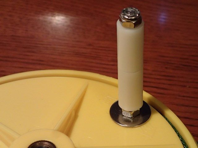

Here's a close-up of the crank handle which I added to the spool of my anchor line reel. A stainless steel bolt is attached to the rim of the spool with two stainless fender washers and a stainless lock nut.  Then I slid two hard nylon spacers over the bolt, held them in place with another stainless lock nut, and cut off the end of the bolt.  The spacers spin freely on the bolt.  Once you have the parts, it's a five minute job.
When I don’t need to be able to break away from my anchor, such as when anchoring while spearfishing, I can replace the buoy with a leash.  I lock off the anchor line with a zig-zag cleat, position the line at my bow with my anchor trolley, and stash the anchor line reel behind my seat.

 I have a couple more questions for you guys. Where did you find nylon spacers that size? Also, how do you have the D rings secured to the strap? Is it just bolted in under the fabric from that handle? Thanks again fellas.
I bought the nylon spacers, and all the other hardware for the cable reel, at my local hardware store, which has several rows of drawers and bins with parts and hardware of all kinds.  The advantage of the nylon spacers is that they're very hard, so they turn freely on top of the threads of a bolt, because the threads can't dig into the plastic.  If you can't find spacers, you could drill a hole in a drawer handle knob, or make your own fishing-reel-like handle from plastic.
I used a soldering gun with a hot-knife tip to cut the webbing to length.  Then I ran each end of the webbing through a D ring, folded it over, and used the soldering gun to melt a hole in the webbing for the bolts which hold the handle to the tie wire reel.  Then I bolted the webbing to the body of the reel with a fender washer.  This is all you need to attach the D rings securely, but if you have an industrial-strength sewing machine or a hand speedy stitcher, you can back up the bolt by sewing the webbing together before you bolt it.
I happened to have some metal D rings.  If you can't find any metal D rings at a hardware or horse equipment store, you could use a metal ring.  I don't think that a plastic D ring would be strong enough to attach a kayak to an anchor system.
