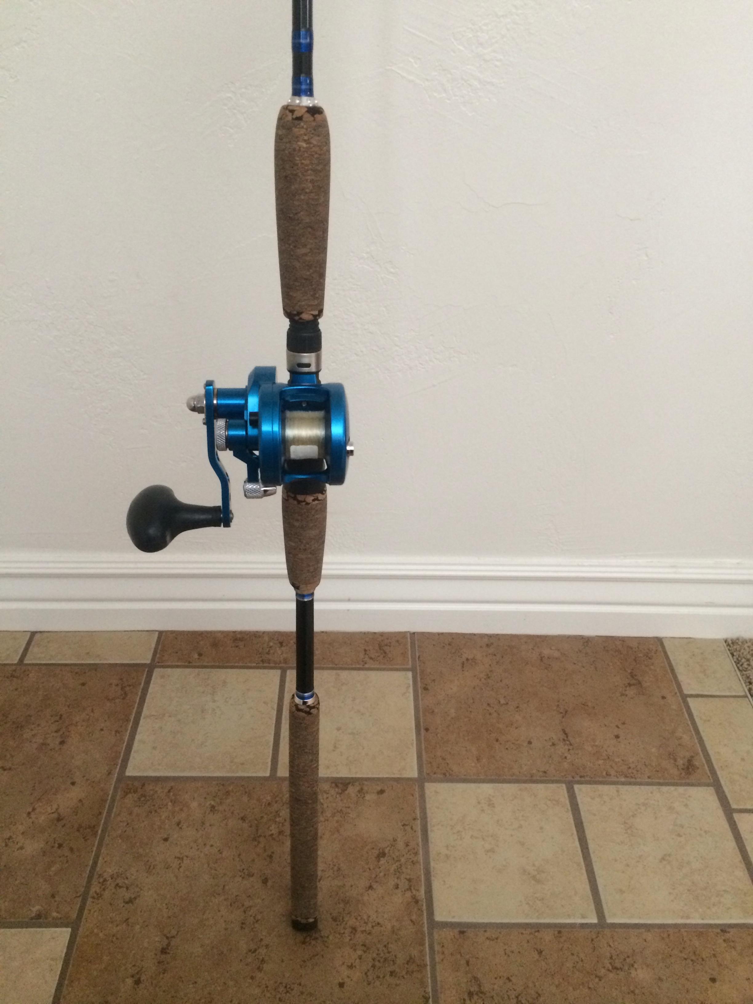

Thanks GB2. I've also repaired / built a few rods. I was just being polite since I really like the rod; these "normal" cracks are actually a bit worse than normal and there is some slight play in a guide or two. The main fault is in the thread finish, maybe they didn't get the ratio right or mix it enough, the blank is still excellent. I also tip wrapped it once and bent over the tip top when the line pulled tight. Once it finally gives up, I'll use the warranty to get another one just like it.
I even mimicked their butt section layout onto a little heavier Lami Triflex blank, that is absolutely killer.
Great looking rod!
Which weight tri-flex is that? They are some of my favorite bottom fishing rods.

Thanks for the compliment! You recommended the 7020 to me a couple years ago, so you get some of the credit as well.
Funny is that I'm honestly unsure of the blank. I got it out of the corner of the Lamiglas factory and it was unlabeled. It was a 7 footer that I cut down to 6' 6". I would guess it's similar to the 7025 .
I recently picked up another similar 7' Triflex blank, a JG841MH. However, I can't find that designation on their site or in their catalog either.  :-\
