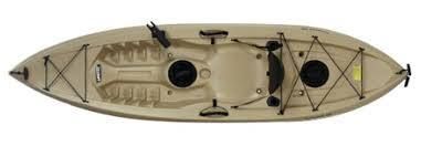

Been reading forums, watching videos, and talking to friends.  The list of mods seems endless to a new yak owner.
Where should a guy start?  Anchor trolley?  Wheels?  More rod holders?
I plan to fish primarily in ponds and rivers with occasional trips in the salt when the weather is kind enough for a 10 foot kayak.
What would you consider to be the must have mods?    I am leaning toward an anchor trolley (river has tide swings) and a milk crate for the back for starters.  Maybe some pool noodle love somewhere?
Here is an image so you know what I am working with.  Any suggestions for the new kid are appreciated.

Fish finder & battery, flag pole, rod holders can go on a milk crate, big game clip & lip grippers " available at ACK" , small dry boxes as tackle organizers

You don't really need to go hog wild on accessories right off the bat.  Give it time to soak in.
However, a flag is a necessity in waters where you will encounter PWC's and power boats.
Compass if you will be in a foggy, or visually challenging environments.
A hand bilge pump, sponge, whistle, and of course PFD.
Use your kayak for a while and obvious things will become apparent as to what YOU need, what YOU want, and what YOU don't need/what.
Everyone here has their own personal preference on what to install, based on THEIR needs and requirements.
If you were to take everyone's input as to what you need to install, you could sink your kayak as there really is that much "stuff" available to install.  90% of which you, me and everyone else could kayak fish without.
Once you have an idea of something specific you want to install that would suit your needs, it makes sense then to ask for input from others for their personal experience when comparing products of similar use.
Also, you will inevitably meet other kayakers while you are out fishing, and this gives you an opportunity to see what they have installed.
Be sure to ask them what they think of their installs, and if they would have done it differently or not.
Go have some fun with your kayak, you still have some summer left to get some great fishing in.

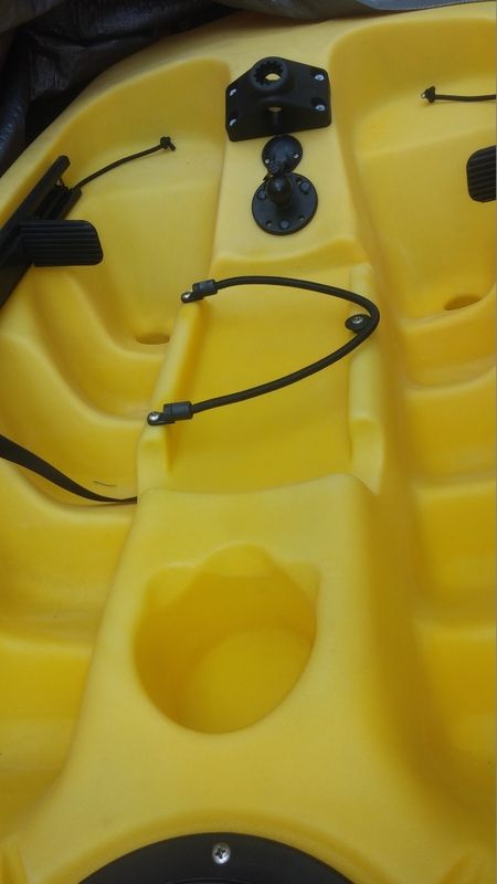

Got most of my safety gear put together.  Still need a wetsuit before I will venture into the bay, but the local river and lakes are all fair game.
Working on leashing things to the yak.  Right now I am using a simple paracord and carabiner setup.  Not fancy, but it works and is cheap.  First aid kit, whistle, radio, mirror, flag, lighter, cigars, knife, PFD.  Did some practice sitting side saddle the other day with no problems.   In all the boat handles well and should serve me well for some time.
Biggest thing I am having a hard time with is reaching stuff behind me.  I am a short and round fellow and I tend to throw my center of balance off when trying to reach behind.  That is where the side saddle sitting will come in handy.
Fish finder and a better storage system for behind the seat are looking to be my first projects along with a set of wheels.
