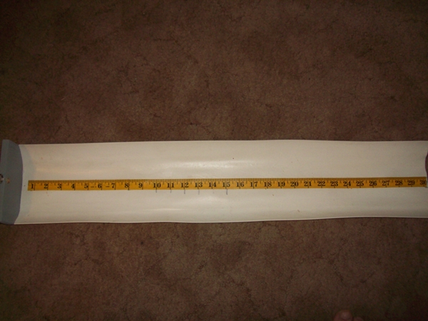

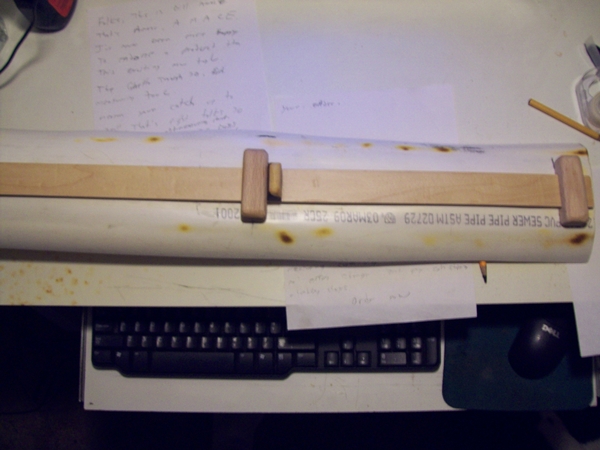

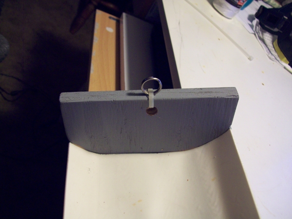

Here's my DIY measurer made from 4 inch PVC sliced in half, heated in the middle then clamped between two pieces of 1x4. Then heated the edges and bent to desired shape.

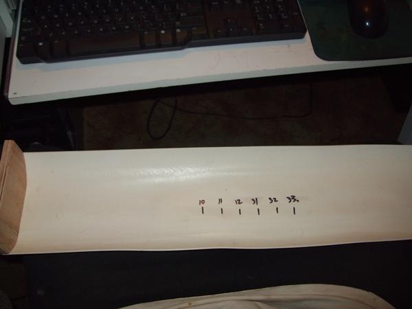

  • Posts: 4767
hey! wait! are those inches? or POINTS you so optimistically scribbled on there?? >:D ???
lol inches. why?

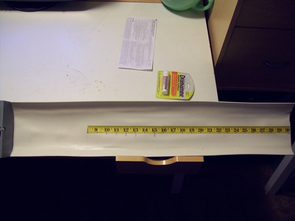

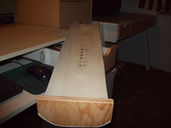

The finishing touches.
leash ring. Does PVC float?
I see you keep the dramamine handy, even when thinking about fishing.   ;D
Jay
LOL, yep. I need to find a wholesale supply, the amount of time i spend on the Ocean. That's how o kep track of how many days I've fished on the ocean, count the empty pill containers

In the interest of keeping things on the up and up for the AOTY I suggest that you put the whole ruler on from 1" on up.
Thanks CBY.

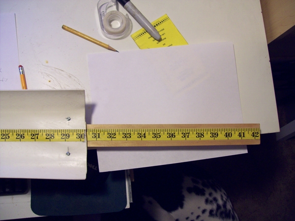

"But Roy, It only measures 30 inches, you say"
Ahh, just engage the extendermatic to to a whopping 42 inches!!
Brought to you by Seewhathappenswhenidon'tgofishing INC.  :D
