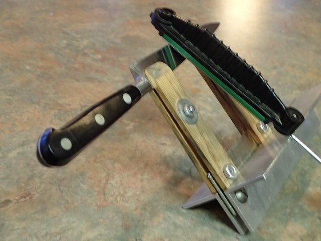

I agree.  Whether you are filleting fish or processing game, having sharp knives is essential.  So I thought I’d show how I sharpen my kitchen knives, and ask how other people keep their knives sharp when processing fish and game.

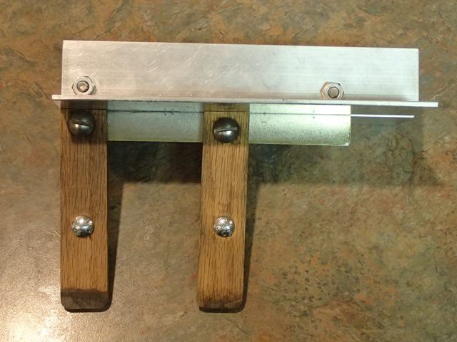

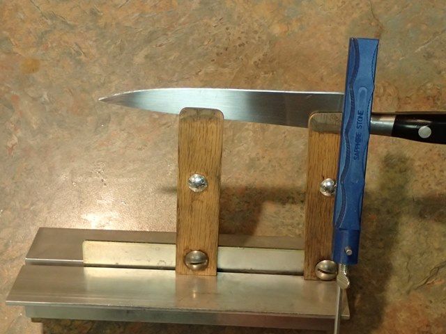

I made a jig which allows me to use diamond sharpening stones to establish an accurate and repeatable bevel over the length of a long knife.  The jig is designed to produce a 22 degree angle on the bevel on each side of a knife blade.  A knife sharpened on this jig has a perfectly flat and shiny bevel on each side of the edge of the knife.
If I’m sharpening a knife for the first time, or if somebody with no appreciation for a keen-edged knife has dinged up the edge of one of my knives, it takes me a while to work the bevels down until they meet in a sharp edge.  But once I get a knife sharpened properly with the jig, it only takes me a couple minutes with a medium and fine hone to restore the edge of a knife.
I lubricate my diamond hones with water.  To check the sharpness of my knives, I run the edge across my thumbnail at an angle.  A sharp knife will cut easily into my thumbnail, and will slide smoothly with no catching or rough spots.
How do other people sharpen their knives?

Pete I'm always impressed with your level of innovation. Fine setup you have there. I also use a diamond steel but I have noticed inconsistencies that limit the accuracy I can achieve on a day to day basis. Your method would take the guessing & minor fluctuations out of the equation & provide a more consistent outcome.
On Another note, I have not had good experiences with Henkel knives holding an edge and I have never recommended them to those who put a lot of wear & tear on their cutlery.
Thanks for sharing.

That Henkel knife is not one of the knives I use for processing fish and game, but it's a nice looking knife, so I stuck it in the jig for the picture.

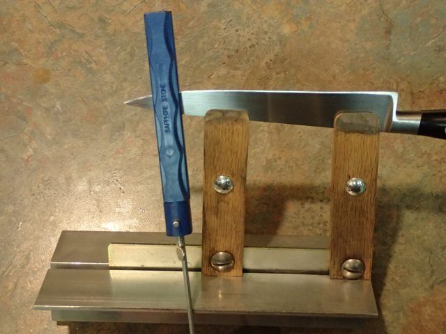

A member of the forum requested some details about how I constructed my knife sharpening jig.  Constructing the jig is pretty easy, but figuring out the dimensions of the jig is the hard part.  So I’ll provide information about the dimensions I chose for my jig.
But some background may be helpful.  A number of companies make knife sharpening jigs, including Lansky and DMT.  But the problem with these jigs is that the stones or hones will only be at a right angle to the edge of the blade when the hone is directly in front of the jaws of the jig.  For example, the following pictures show how the Lansky sharpening jig works.  The DMT jig is similar.  On those jigs, the further the stone is from the jaws of the jig, the smaller the angle of the edge.
This is a big problem when sharpening a long kitchen knife, where the hone will be at a severe angle to the tip of the knife when the jig is clamped in the middle of the blade.
The reason I made my sharpening jig was to allow me to keep the stones at a right angle to the edge of my knives, even long kitchen knives, over the entire length of the edge.
I prefer diamond hones (a) because they stay flat, and don’t develop a dip over time from wear, which reduces the accuracy of a stone, and (b) because they can be lubricated with water, so you don’t need to worry about getting lubricating oil in your fish or meat.

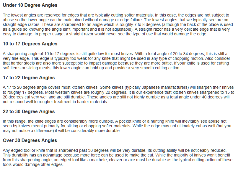

To what angle should you sharpen the edges of the knives which you use to process fish and meat?  Here is a typical discussion of edge angles, from the Lansky webpage:

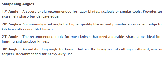

Here is another discussion of edge angles, from a sharpening equipment webpage:
The smaller the angle of the edge of your knives the sharper they will be, but the more fragile their edge will be.  When choosing an edge angle, you need to reach a compromise between the sharpness of the edge and the strength of the edge.  If you have a fillet knife which you only use to slice meat, such as when removing ribs from a fillet, you can sharpen it to a smaller angle such 15-20 degrees.  IF you have a knife which you use to cut through fish bones, such as when removing fillets from the backbone, you will probably want to sharpen it to a larger angle, such as 20-25 degrees, so it doesn’t get dulled as quickly.  I sharpen my fish and meat processing knives to a 22 degree angle, which does a good job of slicing meat, but doesn’t get dull too quickly.  You may choose a different angle.
If you want to make a sharpening jig, the first thing you need to do is buy a set of sharpening stones or hones, because the jig needs to be scaled to the dimensions of the stones or hones.  In particular, the jaws of the jig need to be long enough so you can use the full length of the stones you buy.
I use both DMT and Lansky diamond hones, which have similar dimensions.  Once I get the bevel on the edge of a knife established, I only use the medium, fine, and ultra fine stones.  If the company you buy stones from offers different choices, choose the option which has more choices on the fine end of the spectrum.

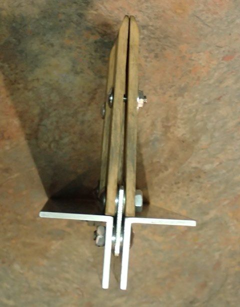

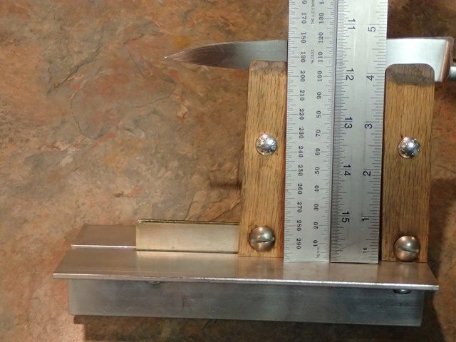

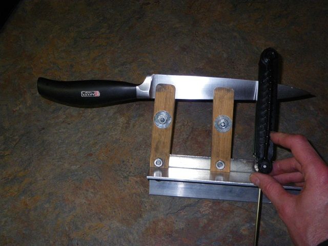

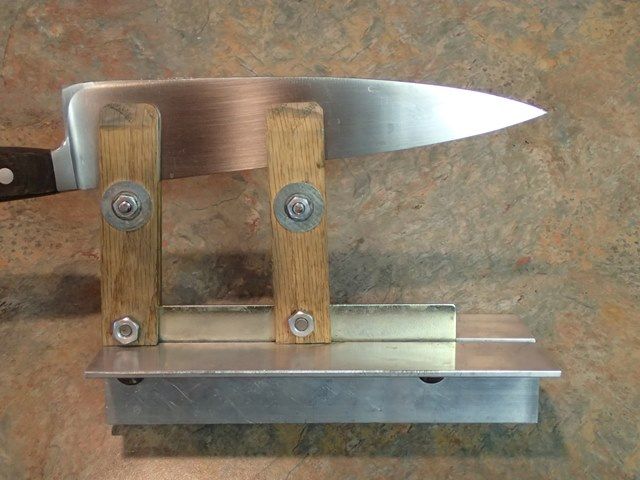

My jig is based around two pieces of 1.5” aluminum angle stock.  These pictures show how it’s constructed.  I can adjust the edge angle of the jig by changing the number of washers between the two pieces of angle iron.

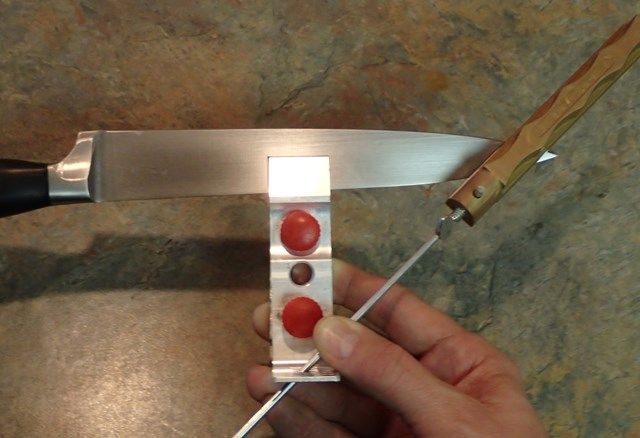

The edge angle set by the jig is measured by putting a straight edge between the edge of the angle iron and the edge of the knife.  However, the edge of the knife needs to stick out beyond the jaws of the jig far enough so the stones don’t hit the end of the jaws rather than the edge of the knife.  And you need to leave a consistent width of blade sticking out beyond the end of the jaws of the jig, so the sharpening angle will be consistent.  These rulers show the length of the jaws on my jig, which are about 4.25” (115 mm) long.
The outer tightening screw needs to be set back far enough from the end of the jaws of the jig to accommodate your widest anticipated knife.  I set the outer tightening screw about 1.75” (4 cm) back from the end of the jaws of my jig to accommodate chef’s knives.
Knives vary in thickness, and on many knives the sides of the blade are not parallel, but rather the blade gets narrower as it approaches the edge.  So you need to be able to adjust not only the distance between the end of the jaws, but the angle between the jaws.  I need to improve the design of the jaws on my jig by adding an adjustment to the back of the jaws (the end next to the angle iron), so the jaws can do a better job of grasping a variety of different knives.  Another improvement to my jig would be to replace the hole in which jaw nearest the tip of the knife is mounted with a slot, so I can adjust the spacing between the jaws to accommodate a wider range of knife lengths.
The first time you sharpen a knife using this kind of jig, you may have to sharpen for a long time using a course stone before the bevels on each side of the knife finally meet to form a sharp edge.  But once you establish those bevels, when the knife gets dulled by use, it’ll only take a couple of minutes to re-sharpen it.  I like very sharp knives for processing fish and game, so during a day of processing a deer or elk I may touch up the edges of my knives several times a day.  If I use my kitchen knives carefully, I only need to sharpen them a couple times a year.
