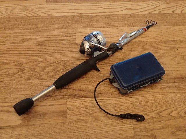

Lots of gear or minimal gear, it's all fishing and its all fun.  Here is my complete outfit for fishing from a whitewater kayak.
But even with this outfit, I couldn't resist adding on and customizing.  Note the hook protector on the shaft of the rod, and the custom-made plastic clip for attaching the tackle box inside my kayak or to my PFD.
