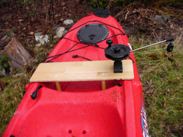

I had a Laketroller on my first Revolution, mounted it on a board and put 1inch dowels so it would ride in the holes for the dolly wheels.  Was stable etc but a pita when you got something, had to twist around and crank horizontally, was a drag (literally ) with a 6lb weight. And if you mounted it farther outboard for easier access,  it tended to pull the boat to that side, so I sold that unit when I sold the Revo, and went to using a Delta Diver.  There's a new diver --the Torpedo that is supposed to get down to 100ft, at 2 mph here's a link:
