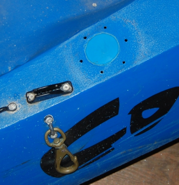

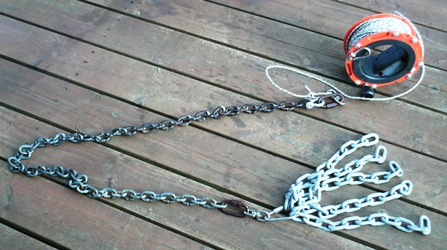

I posted this a few years ago but this is how I set up a drift anchor from a Trident using a custom made bracket and the well nuts that are made for a rudder. There is a cleat up front for the rope.
