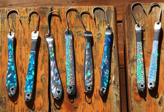

I love making these, and they just plain work!
Goodwill sourced solid handle stainless steel butter knives.
The hooks are 6/0 sticky sharp octopus hooks tied up with 60lb sturgeon leader, knotted, super glued and covered with heat shrink for added awesomeness.
I had to make my own "solid" rings, as I couldn't source them when I needed them. That and they are stupid expensive for what they are. Instead, I just chucked up a 3/8" OD bolt in my hand drill, with a small hole drilled through next to the head.  Slipped a length of 1/16" stainless steel TIG rod to the hole in the bolt and spun the entire length of TIG rod tightly around the bolt.  After this, I just used nippers and cut off rings one at a time from what was essentially a spring.  Using silver solder, I joined the joints closed. And with that, Bob's your uncle!
I found that drilling the stainless can be a pain cold, so I would heat the area up cherry red with a LP torch and drill while it was still hot.  Cut like butter!  Went back with a slightly larger bit and cleaned up each hole.
They range from 1.5oz to 2.5oz and have a really nice drop through the water.  Kinda of shoot in random directions, or flutter a bit depending on the handle shape.
The first time using this set, I had double assist hooks mounted.  This was a bad idea after landing a feisty rock fish that danced violently as I attempted to remove the one hook in his mouth. The other hook was then nicely planted into the tip of a finger and jerked through by the antics of the dancing fish.  To restrain the damn fish, I ended up trying to just grab him, but gut quilled in the palm with one of his dorsal spines.
So for now, I just run a single assist hook.

I made a bunch of knife jigs a few years back. Donated about half of them to the ORC drawing. I think Ling Banger got them. Later, I added stinger hooks to the top. That helped. Lost most of them now. Got to make some more.
Craig - Nice. Based on your pics, I'm gonna upgrade the next batch w/ better eyes & no bottom hook. Maybe I won't lose as many.  :P
Used lure tape & a razor knife for shaping, then coated the lure with polymer coating I use when tying shrimp flies.

Not mine. Google find while looking at other stuff.
Interesting. I'm going to try some of those. Easier than cutting & grinding the blade. Leaving the blade on will add to the weight a little & may add to the flutter.
