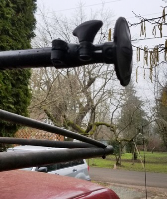

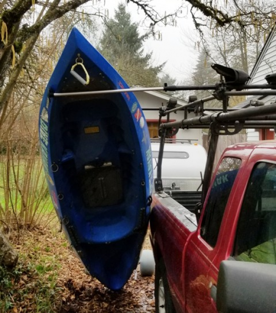

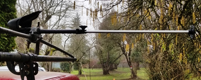

So after putting my Hobie on and off the Thule racks on my truck a couple of different times and dealing with the struggle, Mojo gave me an idea that is easier and will save my back in the long run.  Instead of having the racks extended all the way up and putting the kayak on so it overhangs the cab, keep the racks lower so that the kayak will just clear the truck box.  I tried this setup today and it it MUCH easier to load and unload the kayak but the kayak sits further back on the rack and isn't centered on the rack with equal overhang at the front and back.  I strapped it down in the new lower configuration and it is solid and not going anywhere, as long as the straps don't let loose for some unknown reason.
My question to you all, what are your thoughts?  Will this be ok or should I deal with the higher and harder loading option and hope my back holds out...

I would run a bow line tied to the front crossbar.  If there was a strap failure, the kayak should remain on the racks and not into the windshield following you.
Will the "hang over" beyond the bumper require flagging?

@alpalmer
I always use a cable lock on the boat for safety and theft reasons.  If the straps do let loose for some reason the cable lock will keep it  attached to the rack.  I also will use a flag if I run it like this.

pmmpete's comment about the kayak sliding into the rear window is worth considering.
Even with my T13 overhanging the cab of my tiny short-bed Nissan, there's more kayak hanging off the back of the racks than off the front.  I've been using 2 additional load straps, threaded through the kayak's side handles to the frontmost and most rearward tie downs in the truck bed to keep the kayak from moving front-to-back or skewing from side-to-side, and it seems to be working just fine for me.
Rigging something that would prevent the bow from ever touching the rear glass shouldn't be tough and shouldn't (sorrry Mojo) require welding.

 Be sure to run a tie down from the bow handle to the crossbar to save your back window if you have to get on the binders hard, or get a headache rack.  I wouldn't go cross country like that, but an hour or two trip it'll be fine.  Fly a flag on the rear handle.
