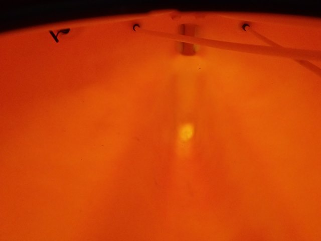

I looked into the stern of my Revolution when the sun was shining on it, and saw a bright spot on the stern end of the keel where the plastic has been worn thin because I rest the kayak on its stern while getting the kayak on top of my car.  How can I protect this spot on the stern from further abrasion?  I don’t want to wear a hole all of the way through the hull of my kayak.

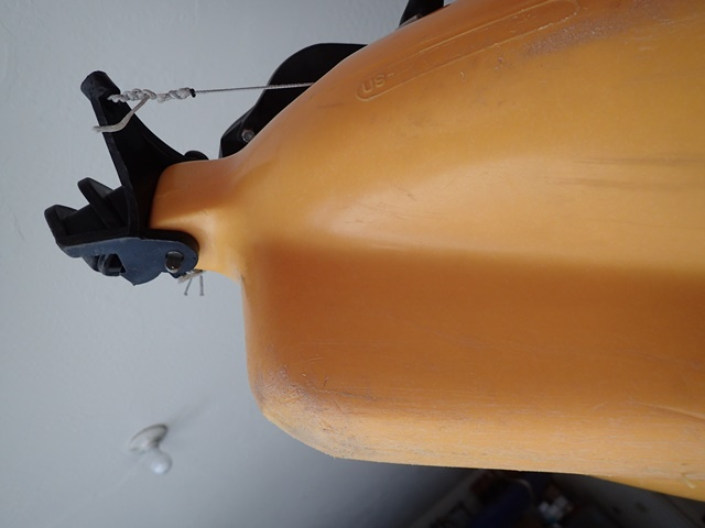

Here's how I addressed the worn spot on the stern of my Revolution:
1. I bought a heavy doormat with rubber backing at the Dollar Store, for (of course) a dollar, and used part of it to make a stern protector which attaches to the kayak with bungie cords, as shown in the first picture below.  I leave this protector on the stern of my kayak when I'm on the road, as there's no reason to take it off.  If I had been using such a protector since I bought the kayak, there wouldn't be any wear on the stern, but I didn't know that wear was going to be a problem. This protector has prevented any further wear on the stern.
2. I bought a Hobie "Welder Pro" plastic welder and some rods of yellow kayak plastic.  This plastic welder is more expensive than many other "soldering iron" style plastic welders, but I bought it because it has a hole in its tip which you feed plastic rods into, so you can melt the rod in the hole while you're melting the hull with the tip of the welder.  This worked very well to build up a blob of plastic on the worn spot on the stern.  The second picture below shows the worn spot before I repaired it.  The third picture shows the area with plastic built up on the worn spot. It isn't a work of art, but it's solidly welded to the stern, and has added quite a bit of plastic to the worn spot. I may add more plastic.  It's easy to do, so why not?
I'll continue to use the stern protector.
