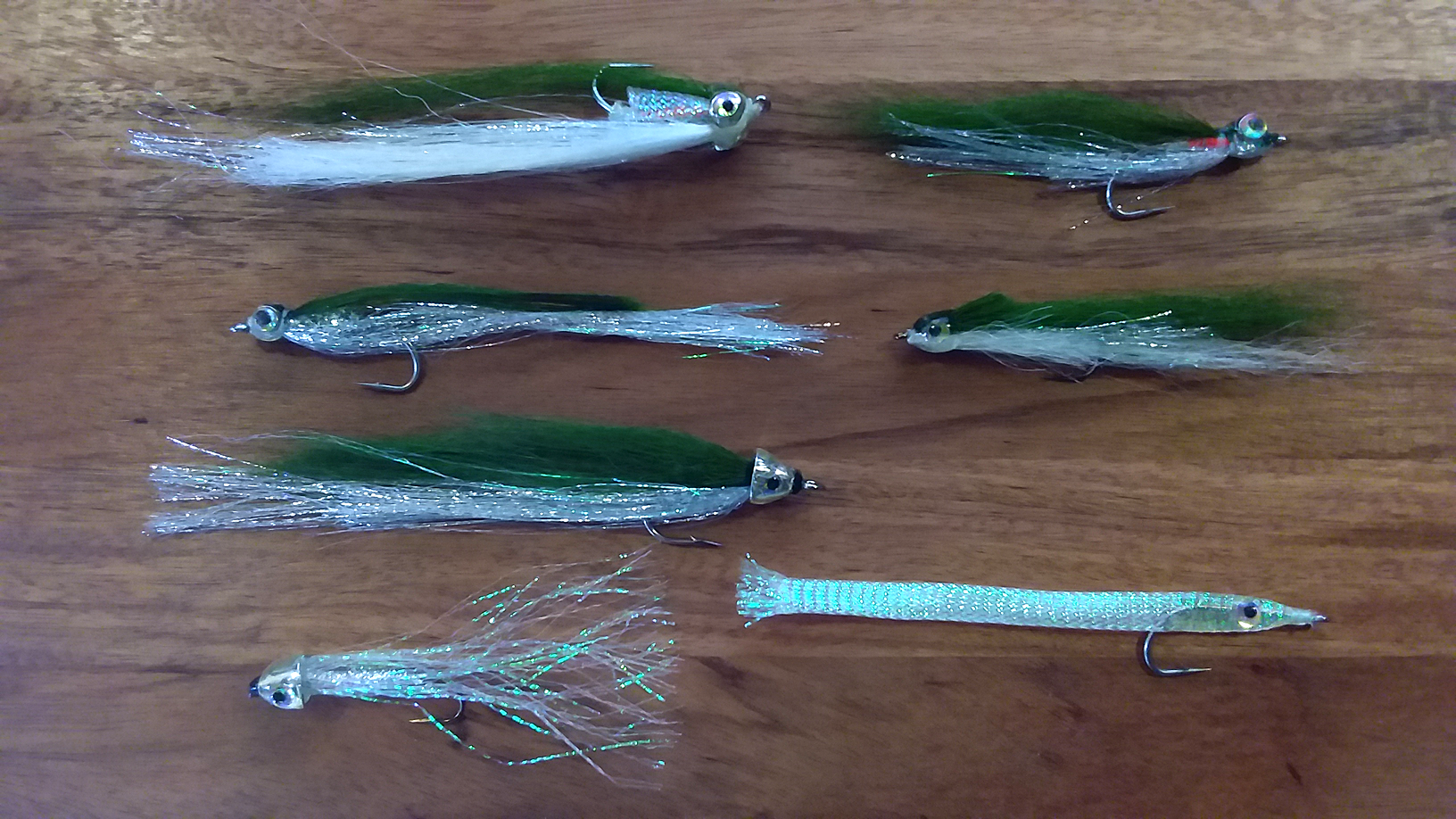

With a renewed interest in using my Outback as a fly fishing platform, my thoughts have turned to a need to fill a void in my fly tying line up, specifically some saltwater patterns which I had no use for until now.
I will disclose the fact that species such as rockfish, greenling, halibut, and flounder are typically not very choosy in their menu selection. For fly tiers at my level you might say that is a blessing in disguise. In the saltwater world those that hesitate go hungry. So attention to the finer details of a pattern, i.e. matching the hatch, are not critical compared to freshwater fishing. When you watch footage of halibut and rockfish repeatedly striking sinkers, shiny spreaders, and even GoPro cameras you get the idea.
It was time to hit Youtube and research tying appropriate patterns which would be fitting for the Alaskan environment. After dozens of videos I still felt I was on my own since no one ties weighted flies (???) so research switched to UW footage of sand eels (Sand Lance/needlefish), herring, and hooligan (smelt) to see what I really need to imitate - not only in shape and color but action too.
The one take-away I got from the fly tying videos was the discovery of how valuable Ultra Violet Resin (UV resin) can be in the construction of large, heavy patterns for deeper water ocean fish. Perhaps I am the last one to become enlightened about this terrific fly tying material. But its now integrated into my war chest for building more durable patterns.
My fishing conditions will vary from enticing a flounder at 10 feet with a shrimp pattern to getting the attention of suspended pelagic rockfish hanging out beginning at 30 feet below sea level down to well, uh, far deeper than I'll be able to reach....without chumming them into "range".
I'm using a menagerie of components to create the weight I need. Lead dumbbell eyes, brass coneheads, lead wire and lead strips as well as meaty hooks should do the trick. The UV resin has made it a piece of cake to secure all these items together into something a fish would be interested in. The bonus is the hardened resin adds its own weight to the mix.
Mind you the flies in the photo are my first attempts but as I progressed through my learning curve I realized another trip to the fly shop area of Sportsmans was necessary to fill in the blanks on my materials list for more realism. I also put in an order for another bottle of SolarEZ thin, hard resin on AMZ as I expect to be using a lot of this in the future.  :)

Those look good.  Definitely should catch some fish.  I have been surprised how many rockfish are feeding not very far below the surface.  I think the majority of rockfish I have caught on the fly were no more than 5-15 ft below the surface.  I use a full sink line and flies weighted similar to yours.  They are so much fun to catch on a fly rod.

For more weight try using Tungsten raw weights by Pro Sportfisher. The are used on tube fly patterns and should slide over some hooks. Then there are Tungsten dumbbell eyes too. On your coneheads if you don't already do it you can fill it up with UV resin to gain some weight and you can always add extra dumbbell eyes the fish don't seem to mind one bit.
LOL!  I noticed some expert tiers had put dumbbell eyes on both ends of their shrimp patterns for added weight. As you say the fish won't seem to mind. When the dinner bell rings, if they snooze they lose. I've seen two-headed trout in fish hatcheries....why not 4-eyed shrimp?
Thanks for the tip on tungsten weights. I'll look into them.  The "fill the conehead with resin" was one of the first revelations I encountered as soon as the pattern was assembled. The shiny interior of the cone allowed for great reflection of the UV light to insure all the resin was activated. When I took it from the vise I realized the second revelation...this stuff is heavy! Thus the large 2 oz bottle on order!
You can also wrap the shank with lead (or lead-free) wire, push it up into the conehead, then fill the cone with resin.  The wire also helps stabilize the cone while gluing it.
