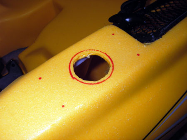

Just a few pics and explanation of a simple rod holder install. Nothing too fancy here and you can use the same principals for all rod holder installs. When the rod holder is bulky or not symmetrical make a template out of paper and trace it on to your hull.
When mounting the rod holder take some time in deciding where to put it. You only get one try at this so make it count. Make sure it will keep your rod and rod butt out of your paddle stroke if you're a paddler and clear of your knees if you're a pedaler. Think about self rescue and landing fish. Ask yourself would it be in the way if you had to self rescue and if you had a large fish would it make pulling it aboard hard? One last thing to consider is if there's things like rudder lines on the inside of the hull. Make sure there's clearance or clear the way during installation.
Once you've found a spot you like make sure you have access to the inside. Try reaching and if you can get there then you can use nuts and bolts. For places where you don't have access you can use pop rivets. Some people like rivets no matter what but that's another story.

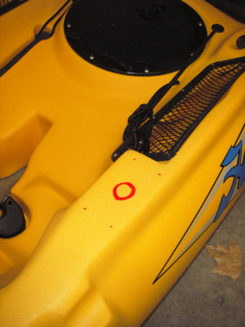

1. Place the mount upside down on the hull or use your template.

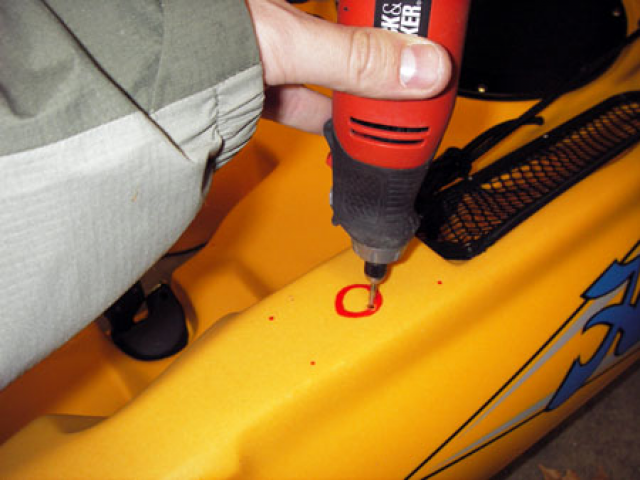

2. Trace all cutting areas.

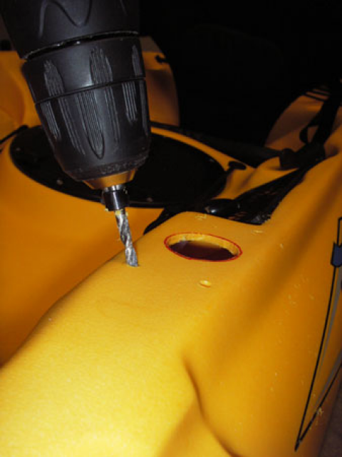

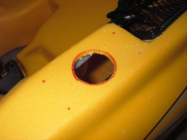

3.Cut out w/ dremel or hole saw.

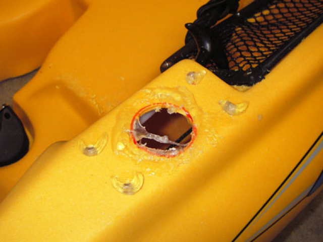

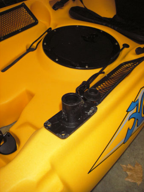

4. Slowly trim to size. Try to rough fit the holder and note which side needs to be shaved.
5. Nice tight fit.
6. Drill out screw/rivet holes. (In this photo angling away from rudder line)

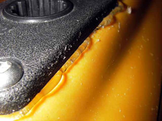

7. Liberally apply Marine Goop around all holes and on underside of rod holder mount.

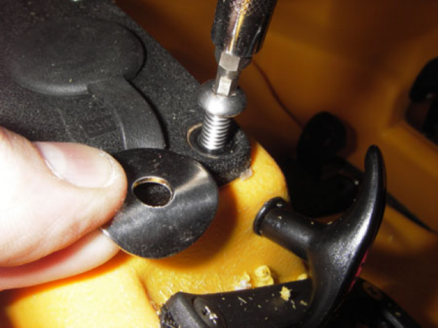

8. Insert all screws and use large washers (all stainless of course). If there's a tight fit w/ hardware customize as needed.

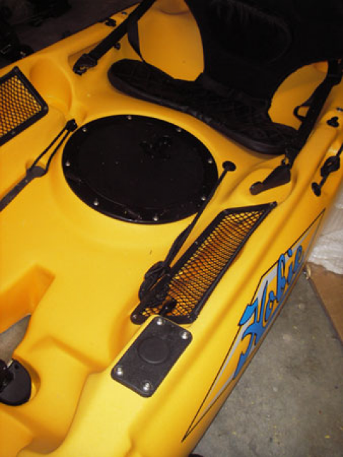

9. A nice bead of Goop gooshing out means a good watertight seal. Clean excess.
10. All done! Now go fish!!
