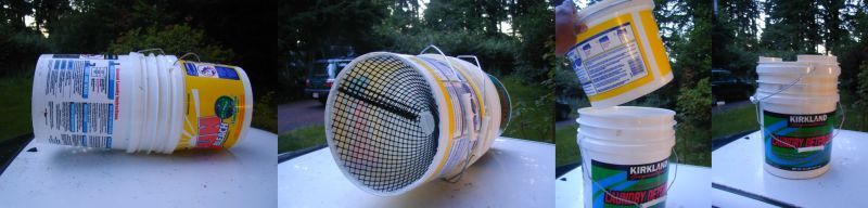

I posted this on ifish almost exactly 4 years ago. I wish I could take credit for this design, but I borrowed it from a commercial crawfisher in the Tualatin whose trap I caught by accident while paddling and fishing (more paddling).  I gave him a call and told him to go run his traps cause they were full (even after I left) and asked him about the area. We chatted and he said there was enough room for a few more traps and even invited me out to run his. He had traps from Cook park to Hillsborough. He was good folks. (Was that you PP?)
 His trap had a hardware cloth cone replacing the bottom of each bucket. My trap uses 1/2" square plastic fence material instead of hardware cloth. The cones on my first ones were held with hot glue, but hog rings work a whole lot better. A couple of rail spike to sink it and your in business. The buckets are held together with two small bungees. My FAVORITE crawfish bait? Shad by a long shot!
The bottom sequence is kinda reversed. The pic on the left is the trap ready to work. The pic on the right is taken apart, nested, and ready to travel.

Thanks for the info and pics FFT. I'll have to try it.

That's an interesting set up and it looks likes it would work great.
Sure beats the string-tied-on-a-stick-with-a-piece-of-dead-chicken-for-bait system I used in the irrigation ditches.

Very nice. Thanks FFTW! I'm going to have to make up a few. I'll "wing it" from looking at your pics.  I have a bunch of black plastic planters left over from all the trees and shrubs i have planted over the years. Might have some mesh I can use. I'll have to comb thru my junk piles.  I've got several different sizes of plastic pots, too. I should be able to make up a few good traps. And I know some good spots to put 'em! >:D

Thanks for sharing the trap.  I was thinking of building something similar but smaller.

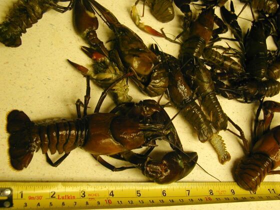

Yaaa, but did they catch critter's like these? :laughing7:
Nah, you'd have to have a bigger hole   ;D  But there was no point, we would catch them in the drainage 'ditch' in the back, then use them to catch LMB - which were also residents in the drainage 'ditch'  (yes, there was Banjo music)
Where were you catching those?
-Craig
Springfield Nuclear Plant retention pond :tard:
