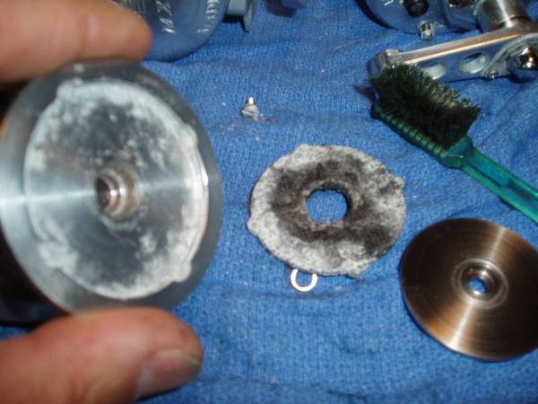

But the not so pretty side..

how long does it take for that to happen to the drag washers??

Zee, you been draggin that reel behind the boat???   Never saw one that scuzzy outside of my old Penn 209.
   I lOVE my avet, spins for nearly 90 seconds.  Gets a nice backlash with a cold thumb, tho!!!
Those aren't mine. They come from Alan Tani's reel repair website www.alantani.com.
Correct me if I'm wrong, but isn't that crusty white corrosion looking stuff between the drag disc and the spool the glue they use to hold it in place? (CA?) Seems I read that on Tani's page or Charkbait. Whatever it was, it was a PITA to clean.
BTW: I've been using ATF (automatic transmission fluid) to lube the bearings. I read that somewhere too. The ATF seems to give as free a spool as Hot Sauce and then magging it has REEEEALY tamed the birds and compensated for my dumb thumb without compromising distance.

Did the other SX this morning.  Decided to pack the handle shaft space anyways.  But I don't think that's where the majority of the water comes in.  I think it comes in at the endplate.  The SX endplate sits over the top of the end of the frame.  Water can go straight through there to the dragplate.  The progears, on the other hand sit inside the end of the frame, with sort of lip.
Anyways, the moral is still the same.  Service your SX's often.
  • Posts: 4767
any room to put an "O" ring gasket in the end of the reels?
Hmmm ... maybe it's not the endplate.  Maybe it's the gap between the spool and the frame.  No way to plug that one ...
I guess perhaps it is just inherent to lever drags with the drag plate on the end of the spool.  On star drag systems the  drag washers are in a different area altogether an no where near water that might come in by the spool.
