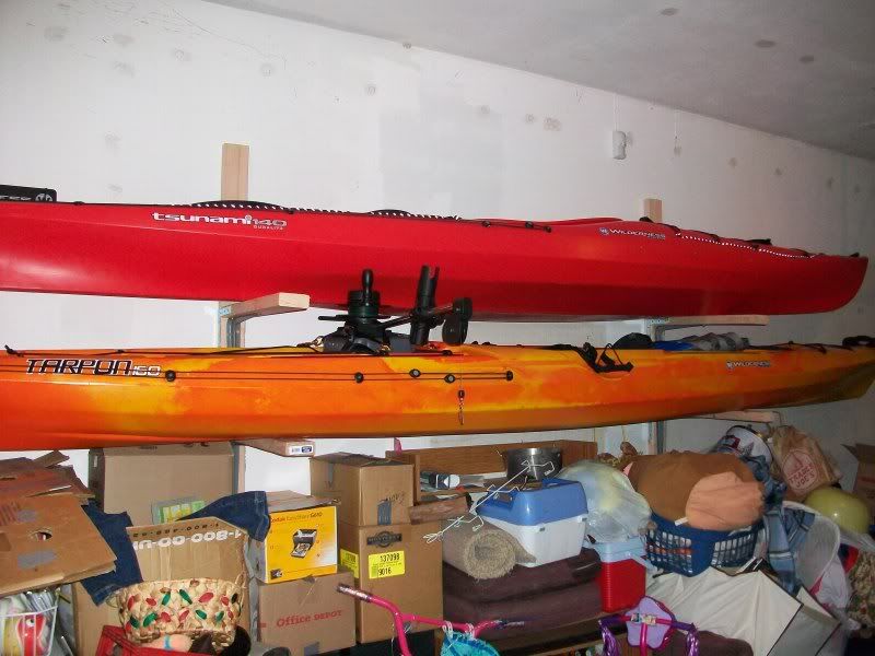

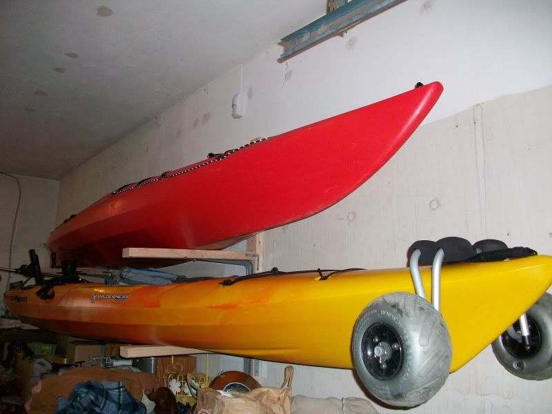

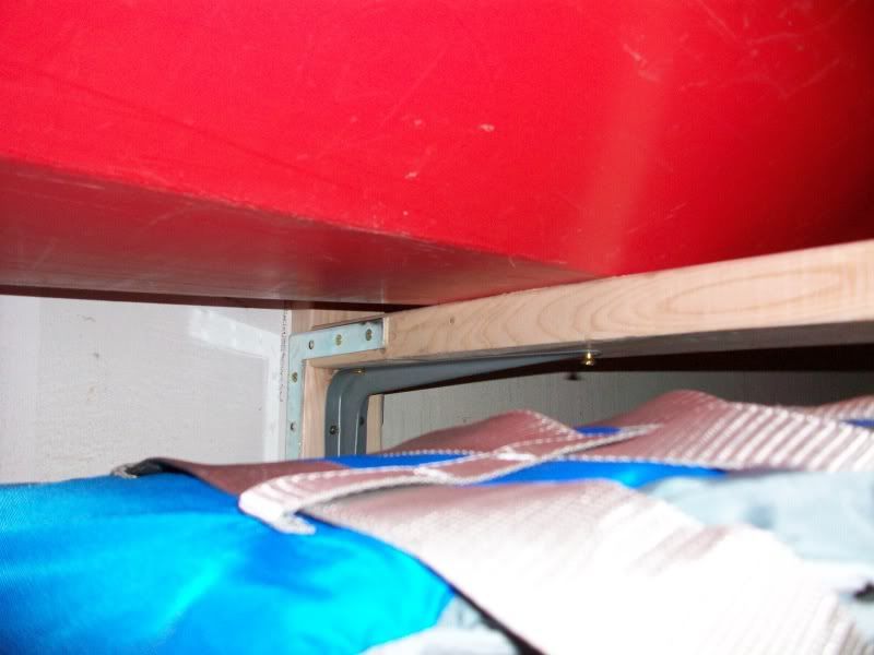

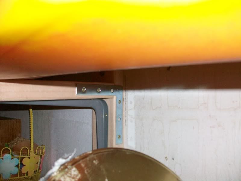

For $20.47 I picked up 3 2x4s, screws and 4 metal shelf supports.
Screwed two of the 2x4s to studs in my garage wall, then cut the remaining board into 4 two foot pieces.  Screwed them to the supports, then to the wall.  The support brackets CLAIM to hold 110 pounds each; however, they were flexing more than I'm comfortable with under 70 pounds of kayak distributed over two of them.
Tonight I'm going to grab 4 L shaped brackets to screw into the side of the 2x4s for additional support and to make it a little more rigid of a setup.

When you get it done could you give us a few pictures of it?

Finished it the date of my last post   :)

Thanks a bunch for the pics Lee.  Looks to be plenty strong enough and that might work good in my garage.  That 160I sure is sleek looking.
Ya may want to flip those yaks over so you don't tweak the hull(s).
I'm adding some foam for the SIK.  The Tarpon looks to be better sitting on its belly.
