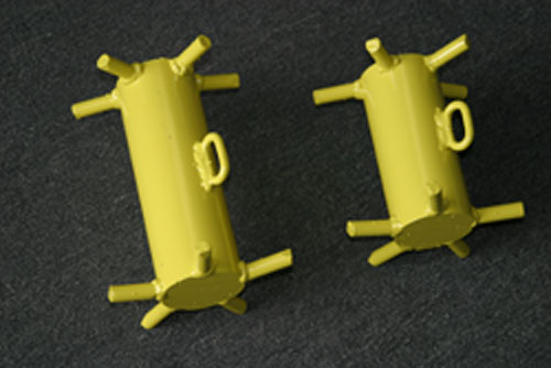

When kayaking here in Ca. , I don't have to deal with the rocky river bottoms you have except when on steelhead rivers, but for my drift boat I have an "Animal anchor" I bought from Willie Boats years ago, the thing weighs about 20 lb. 3"x12" steel tubing filled with lead shot and rebar whiskers poking out of the ends, it never gets stuck (knock wood) and pretty much always holds.
Dave Scadden pontoon boats at www. northforkoutdoors.com sell a 12 and 15 lb model (pictured below ) for $40 to $50 bucks, but I don't think we need one that heavy for kayaks.
I think a person could weld one up for about $10 worth of 2" x 10" pipe, some rebar, and some pipe end caps from Home Depot. I would use screw on caps and fill with lead shot until you get the weight right. If you don't weld, another $5 for a sixer of beer for a friend and a few crabs should get the job done. I would think 5 lb total weight should be max needed. If you used the right size and length of pipe, you could use it the stash  stuff too( extra beer   :occasion14: ).
I would keep a 9"x13" cake pan in the tankwell to store an "Animal Anchor" . I wouldn't want those rebar legs poking a hole in the boat.
