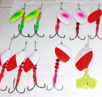

Spinners such as Yakima Baits "Bob Toman" or Luhr Jensens "Guide Tech" are the easiest to troll.  They tend to have really good results as well.

"Blue fox would work ok but i would put it behind a flasher and a little weight, a spinner by itself will just be a junk(smugula,as Ralph cals it) grabber . I'm using brads cut plug behind a dees flasher with a 12 inch dropper to 1-2 ounce cannonball. I don't know the area so may use more weight if there is stronger current."
