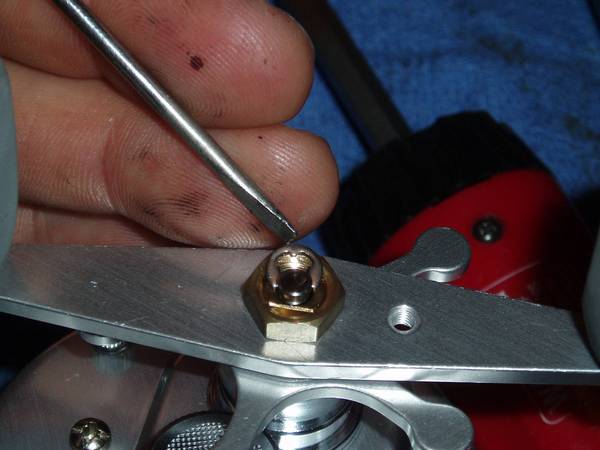

remove the handle nut  cap and screw (key #'s 14868, 96274 and 15359)
remove the c-clip (key #4490)
remove the handle nut (key #15359), the handle (key # 24500), the stainless steel spring (key # 5115), the star (key # 24502) and the cast control knob (key #'s 21717, 20917, and 20090)
