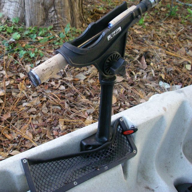

I installed a surface mount scotty rod holder socket in the pocket on my Adventure. I saw it on somebody's boat and I thought it was sheer genius. It looked like it should have been a perfect mount; solid, secure, out of the way, yet well within reach.
First two counts were spot on. The "out of the way" part... not so much.  I plan to try it for the fishfinder, but I'm not going to drill any holes till I try it out on the water (a VERY good idea before you make any permanent mounts).
It's really not that bad, but it's a bit too close for my taste. The flat just in front of the pocket (above the rudder control) works much better for me.

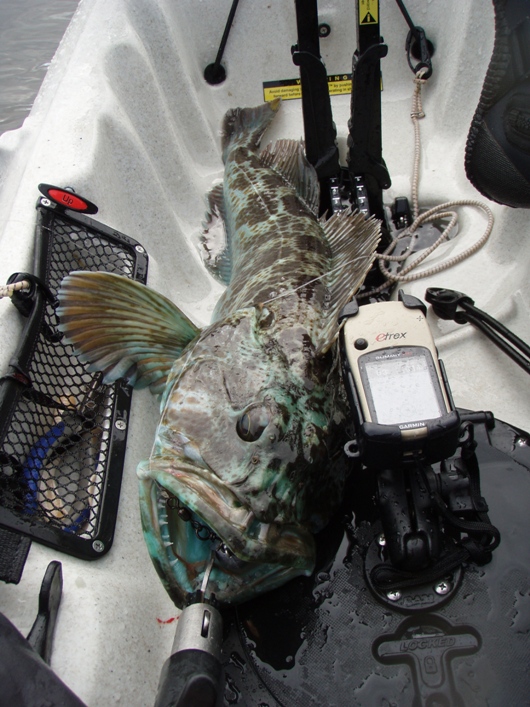

Mounting my GPS on the center hatch of my Revo was a bad idea.
Line and other things would easily wrap around it and it made it difficult to sit side saddle and access the front hatch.  I would argue mounting anything in the middle of the seat area of that boat isn't a good idea.
