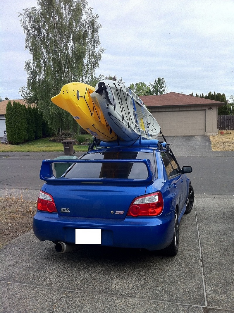

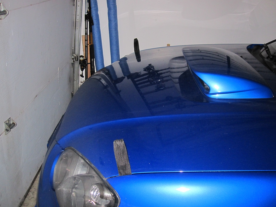

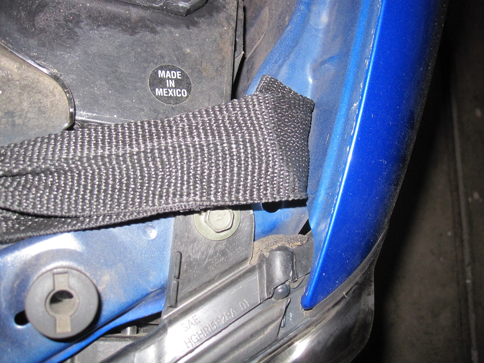

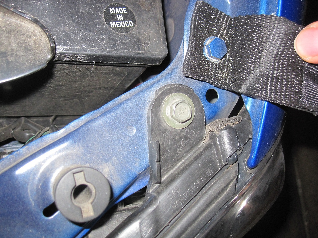

I made front tie downs for my car because I didnt want it to go over the bumper. First I started with 1" - 2" webbing. Folded them in half and sewed the to make a loop. Then heated up a screw driver(small one) and melted holes into them so they could fit a screw through it. In the second picture you will see the fender bolt I used to hold it down. and in the third pic is what it looks like with them out. I like the webbing option because when im not using them I can just flip them over and they will stay hidden. The fourth pic is my two yaks on my car using the Yakima stacker.

Does that wing help any? :P
Great Idea on some tiedown spots.
Dont know, but I have gone 70mph with the yaks up there on my way to Hagg.
