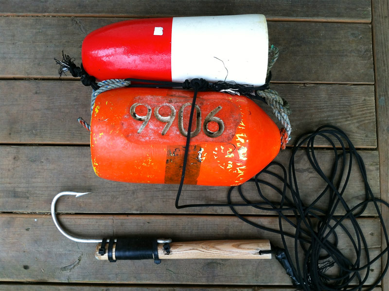

Here's what I have been using and it seems to work pretty well.  Inspired by fungunnin's setup.  It's massively jury-rigged, consistent with the kayak angling spirit ;)
The hook is a shark hook.  I am not sure what size that would be (20/0?) or even if shark hooks have sizes.  It was in the "shark hook" bin at the marine store.  Bill used the gaff hook only from a flying gaff. Basically what you want is a giant hook, with a barb on it (this is why a regular gaff won't work).  I sharpened that hook til it was needle-sharp, then put a piece of pool noodle over it until I was ready to fish.
I duct-taped that to a fish billy club (i.e. "wood shampoo").  Any 2-foot wood handle will work.  Though a broom handle may be too narrow.  Last thing you want is your handle to bust when you're driving the hook in. Anyway, the duct tape is really just to hold it on straight.  I secured the hook to the club using 4 of the beefy-sized zipties, pulled super tight with pliers.  Rawkfish used hose clamps, also a good idea.  Drill a hole at the other end of the handle to run the line through.  So that's the business end.
The buoy end is just a shrimp and a crab buoy tied together.  Last year I used a large boat fender rigged sideways and that worked fine, but I wanted something lighter.  Note that the line runs out of the middle (rather than the end) for maximum floatation.
15 feet of anchor line connects the gaff to the buoy.  Only thing I am going to change is that I'm going to use a floating line.  Anchor line sinks.  I didn't have trouble, but recognized the potential for it.  Floating line will be better because it is less likely to get tangled on your mainline either before or after the fish is gaffed.
A 100+lb fish will pull this under.  But at this point I am leaning more in favor of portability vs the likelihood of hooking that big of a fish.  And, let's say you do hook a fish that big...the fact that he pulls the buoy under doesn't mean that much, it's still pulling against him, it'll just take longer to tire him.  And, you should hopefully still have your mainline hook in his mouth.
That's a rockin setup Rory!  You come up with some great gear man.  I'm still in awe of the Iron Maiden.  This too shall be assimilated into my aresenal.
