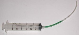

I've tried all the below methods in this order.
-Drinking water bottle.
-Small cup about the size of Dixey.
-Sponge.
-Spongee towel.
-Plastic syringe.
-Plastic syringe with tube extention.  (Note: This is not a picture of the one I actually use)
The plastic syringe is my go to method as of now and is stored in my battery dry bag.
The tube comes off and is stored next to the syringe handle in the body of the syringe.
No mess, no fuss!
