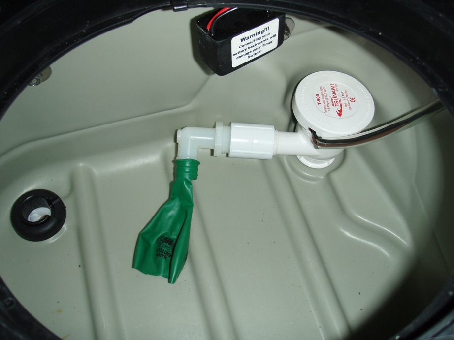

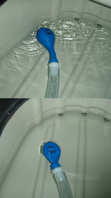

The first component I added was a waterproof electrical timer switch.  I had this switch from my days working for Anglers Yak Shack but you can find them around the web for around $40.  I wired it in series between the switch and the pump.  The pump turns on for 7 seconds, then shuts off for 21 seconds, giving the pump a 25% duty cycle.  While re-wiring the tank, I also greased the hell out of the on/off switch with dielectric silicone grease since I’ve heard it isn’t exactly a corrosion-resistant piece.
After adding just the timer switch, two obvious problems were obvious.  After the pump stops pumping, most of the water that was just pumped into the tank flows right back out though the pump.  Also, if there’s not enough water in the tank, the pump needs to be re-primed after every cycle.  The obvious fix for this is a check valve of some sort.  I tried a couple from the hardware store but realized that the pump doesn’t push the water into the tank with the requisite force to open most PVC check valves.  This means the check valve needs to operate on the suction force created by water trying to flow back out through the pump.  Home Depot has a fitting meant for sprinkler systems that operates on suction rather than the force of forward flow that would probably work, but after trolling the interwebs, I stumbled across this little gem of an idea:
My 2 cent Hobie Livewell modification
It seemed cheap, shoddy, and flat out ridiculous, but I had to give it a shot.  I slapped on a “Happy Birthday” balloon with a slit in the top from the local grocery store and to my surprise, it worked flawlessly!  I added the piece of tubing to the outflow fitting of the pump to make testing easier and have removed it for regular use.  However, I found that an extra fittings (pictured below) are needed to get the balloon to function as a check valve. The balloon cannot be simply placed over the outflow fitting of the pump.

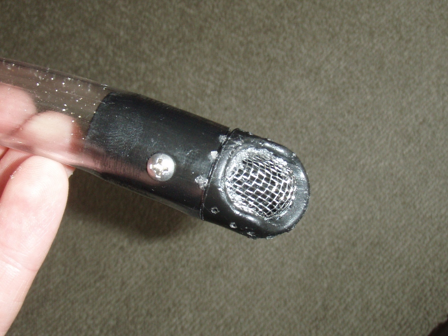

I picked up a stainless steel mesh sink strainer at the local hardware store and cut out a piece I thought would be big enough to fit into the scoop fitting on the end of the intake tube.
After trimming here and there, I molded it around my pinky finger and it fit just right.  I gooped the inside of the scoop fitting at the entrance really well and slid the screen into place.  Before the goop was set I pushed the screen out a little from the inside to get it to stick out of the scoop a little.  When the goop was set, I picked off little chunks of goop that would impede the flow of water through the screen with a tweezers as best I could.

I have now used the system several times out on the ocean a variety of places where there is plenty of marine vegetation and other organic debris.  The system has not become clogged with debris or weeds and the tank has always been able to fill within a reasonable amount of time.  I have not fully measured the battery life yet, but I was able to run it for two long days on the water for a total run time of over 12 hours without a recharge and I did not notice any decrease in flow velocity provided by the pump.
I was really impressed with the cheap check valve and then chased the link right back here. (Jacksonville) Who'da thunk it? Small world.
:notworthy:  :headbang:  Nice bit if engineering work there Rawky!
