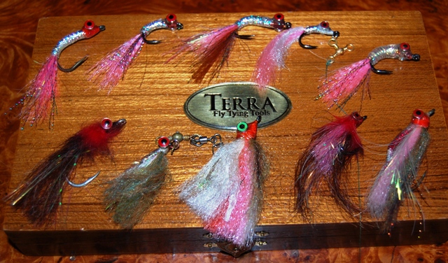

I've been tying them for about a year & use mostly synthetics. lost several of them last season, so I'm tying more. Gonna take a bunch with me when we go to GS-7 down in Shelter Cove. They were fairly popular last year. These worked really well tied about 12" above a jig.
. Got a few more pics in my gallery & will take more pics of the new ones.

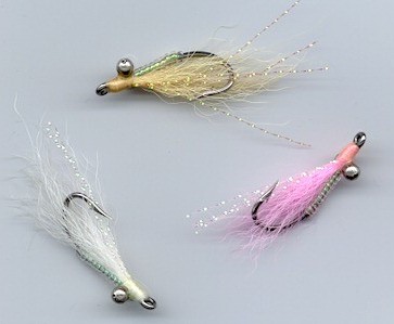

Paul,  are those Crazy Charlies?  Or some variant of them?  Bonefish flies!
Yes, I have a box of bonefish flies left over from Christmas island.  I've been using them for mackerel sabikis (size 6's)  and rockfish flies (size 2's).  Was going to swing a few for steelhead and toss some for surfperch.  May even troll some of the small pink ones behind small dodgers for kokes.  And I'm sure the larger pink ones would do a number of pink salmon.  It would be fun to see how many species I could get on them.

LOL,  Possibly cabelas but I was thinking  he got them from caddis fly shop.
yes, crazy charlies. i used them with great success last year, especially in the spring when the brf were top feeding on crab larva. i'd like to try a modified clouser behind a flasher & see what happens.
both of these have trailer hooks.

What size hooks you been tying them on?
haha... got the materials from caddis fly. need to go back for more materials.

size 1 & 2. Sometimes bigger if I get the urge. 1/0 for the front & #1 for the trailer on the clousers

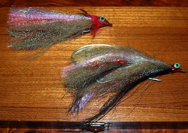

Been tying rockfish and greenling flies in sizes 2-3/0 and lingcod flies in sizes 3/0- 5/0 hooks. Using a lot of synethetic and some natural hair, just depends on the size/color and the bulk I want . The flies range from 2'' to almost 12" long. Using bucktail,and craft fur,super hair and bunny strips for the smaller flies and for the bigger flies, lots and lots of yak hair along with super hair.
Scott
pictures?

Curious....I have never tied a fly with a stinger or trailer hook.  Would like to try to tie some of my striper clousers a bit different for Rockfish and add a stinger....  What's the best method for tying a stinger in on larger, longer flies?
Thanks in advance!!!
