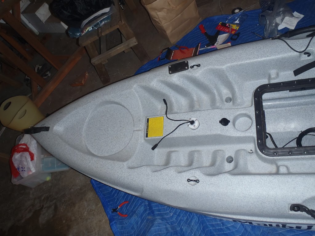

I used this on mini x. Got it from west marine. I don't like the way it sticks out so I think there are better options but it hasn't been a problem yet and is watertight. Just another option.
http://lh3.googleusercontent.com/-kfDY3TEoubY/TYoQSqvWcKI/AAAAAAAABBc/611PMnxalu0/s1024/Kayak%20mod%203.JPG

West Marine.  I think they are right at 6 bucks so maybe not the cheapest option but I like the finished look.
That is kick ass clean and professional looking right there.  Beats the heck out of my rubber stopper.  If I have to replace my stopper or run more wires, I'm looking for one of those fittings for sure.

Thanks.  Very timely as I am about to rewire (again) the Revo13 after I install the YakAttack GT90s.  Now the power and transducer cables run up and under the bow hatch, but I have a hole where the unused, superceded, power plug is still located.
I was going to use the waterproof pass throughs from Hook1 on my ducer cable. The hole required was too large, so I went rubber stopper. Not the greatest looking, but it doesn't leak.
I think the ducer connector on my 597 was 3/8" wide, which needed the 3/4" fitting, which would have required a 1" hole. About twice as big a hole as actually needed to run the wire.
Wonder how big a hole you need to drill for the West Marine cable clams?

Funny, I just punched that hole a few minutes ago and put it away to dry. The West Marine thru plugs need a 1" hole, much bigger than the typical terminal plug for a FF, but they finish off well and you can pack them with silicone. Yes, I found myself apologizing aloud when I drilled a 1" hole thru the deck, and I paddle fiberglass....ouch. But the final product looks clean.
