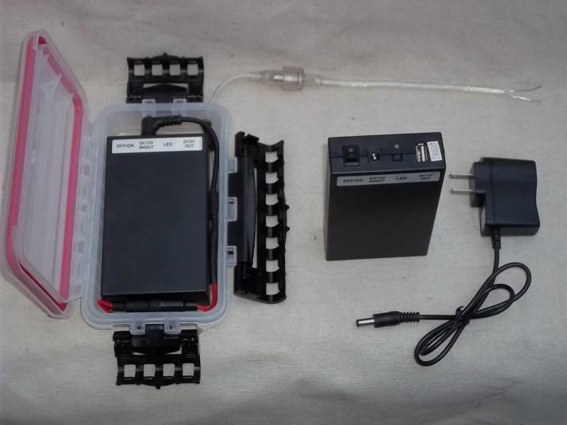

I don't have a picture, but it's simply a tupperware type of container that I glued some foam in to hold the battery securely, then I drilled a hole exactly where the power plug needs to go.  Nothing fancy and it isn't waterproof (only because of the hole).  I can't see how water is going to be an issue unless I've got the hatch open and a tidal wave hits me, in which case my heirs can lament my stupidity.
I got the Anker 20,000 as listed here;
http://www.amazon.com/20000mAh-Aluminum-Multi-Voltage-PowerIQTM-Technology/dp/B005NGLTZQ/ref=sr_1_1?s=electronics&ie=UTF8&qid=1421783063&sr=1-1&keywords=anker+charger+20%2C000
I haven't used it enough to get a sense of battery life, but so far it appears that it is more than sufficient and it handles the 12 volt system fine.  Plug it in and turn on the DF within a half a minute or so and you're set.  I can't see why I couldn't be charging my cell phone on it at the same time but I haven't tried that yet.
One thing about these is if there is no current draw, they turn themselves off.  So if you turn your FF off then you may need to open the case and turn the battery back on again later.  WillBD added a usb cable and leaves his phone charging at the same time in the same dry box so it prevents the battery from turning off if you turn the FF off. Brilliant solution and a fully charged phone too.

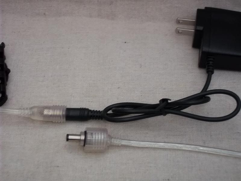

I would strongly encourage using an inline fuse "just in case"  This is a very poorly drawn example of how I have wired mine up.  using an inline fuse and a waterproof connector between my battery box and leads to fish finder.  I started using waterproof 3.5mm connectors which allow me to easily disconnect my FF and plug in the charger.

Found dirt cheap if you do a search on ebay for LED WATERPROOF CONNECTOR and don't mind the wait on shipping.  Typically under $2 a set shipping included.
I have used them for other applications where they have sat submerged in water over the winter without fail.  Every other time that I separate the connections I just toss a bit of Dielectric Grease not only on the connector itself but a little around the threads and O-Rings to keep them in good shape.
