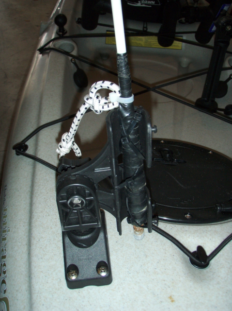

Make it as high as possible.  As a bare minimum it needs to be at least a couple of feet above your head when you're sitting in the kayak IMO.  I use a fiberglass ATV whip flag pole.  I think it's about 7 foot, maybe more.  It was super cheap and I just zip-tied it to a rod holder and.... aw hell, here's a pic:
I don't have the bungee chord on there anymore btw.  It doesn't need to be fancy, I just had that rod holder laying around so I used it.
