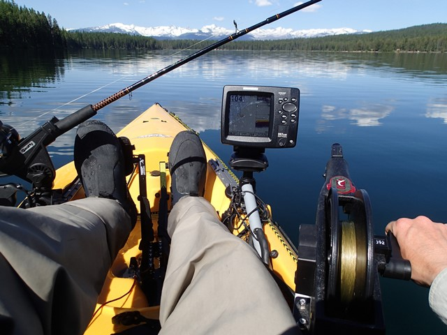

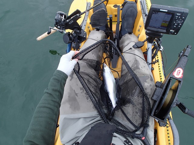

The downrigger is mounted where it’s easy to operate.  I have mounted the downrigger next to my right thigh so it’s easy to operate from a relaxed and natural position while pedaling my kayak.  I don’t have to reach far forward or far backward, stop pedaling, change position in my seat, or turn sideways in my seat to operate the downrigger, and turning the downrigger’s crank doesn’t put a strain on my shoulder.
The boom of the downrigger has been shortened.  The downrigger’s boom has been shortened as much as possible in order to make it easier to position its cable right next to the side of the kayak, to make it easier to reach its weight and release, and to minimize the stress which the downrigger places on the hull of my kayak.  A downrigger with a two-foot-long boom is like a crowbar which is trying to tear the downrigger’s base out of the gunwale of your kayak.
The cable is positioned close to the side of my kayak.  The boom and pulley of my downrigger are positioned so the downrigger’s cable is located only an inch or so from the side of my kayak, to minimize the effect of the drag from the cable and weight on the tracking of my kayak.
The weight is located where I can reach it easily.  When the downrigger’s weight is at the surface, I can grab it easily to clip my line to the downrigger release or to hang the weight on a hook which I have mounted on the downrigger’s base, while sitting with my weight centered in my kayak. If you install and orient your downrigger in a manner which requires you to lean out over the side of your kayak every time you clip your line into your downrigger release, you unbalance your kayak, which can create problems if you are trolling in rough water.
The rod is mounted where it’s easy to monitor its tip.  I have mounted my rod in front of me and at right angles to my kayak, so I can monitor its tip for strikes without turning my head very much.  If your trolling rod is mounted behind you, you’ll miss a lot of strikes and get a sore neck.  For a description of how I made the base for my rod holder, see http://www.northwestkayakanglers.com/index.php?topic=13167.msg144750#msg144750 .
The rod is mounted where I can reach it easily.  I have mounted my rod where I only need to lean forward slightly to operate its reel, and where I can grab it out of its rod holder quickly and easily when I get a strike.  The handle of the reel is facing me so I can reel in line while the rod is in its holder.  The reel is close enough to my downrigger so I can reel in fishing line at the same time that I’m cranking up the downrigger weight, so my rod and fishing line stay under tension while I’m cranking up my weight.
The rod is mounted so it crosses the centerline of my kayak.  I mount my trolling rod on the left gunwale of my kayak with the tip pointing to the right, so its reel moves towards the centerline of my kayak when I remove the rod from its holder, and I can keep my body solidly centered in my kayak when removing the rod from its holder.  If I mounted my trolling rod on the right gunwale of my kayak with the tip pointing to the right, unless I used a clamshell style of rod holder which releases straight up, like the Folbe Advantage or the Scotty Oraca, I'd need to reach out to the right of my kayak to take the rod out of its holder, which would risk unbalancing my kayak, particularly when wrestling with a big fish.  I position my rod so it is a couple inches behind my left toe when my left pedal is all of the way back.  Neither the shaft or the butt of the rod interferes with pedaling in this position, and I can mount the rod holder right above the gunwale.  I don't raise my rod holders above the gunwales of my kayak with extenders, because they place additional leverage on the rod holder's base and the hull of the kayak.
The rod holder holds the reel firmly.  Choose a rod holder which holds your reel firmly in place, so the reel won't flop around in the rod holder when you're reeling in fishing line and cranking up your downrigger weight at the same time, or when you're releasing line from your reel while you lower your downrigger weight.
The fish finder is mounted on the same side of my kayak as the downrigger.  My fish finder is mounted on the same side of my kayak as the downrigger, so I can monitor the fish finder and the tip of my rod at the same time, without turning my head to look from one to the other.

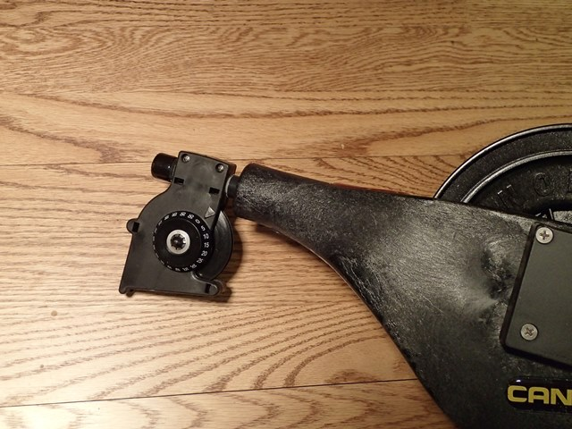

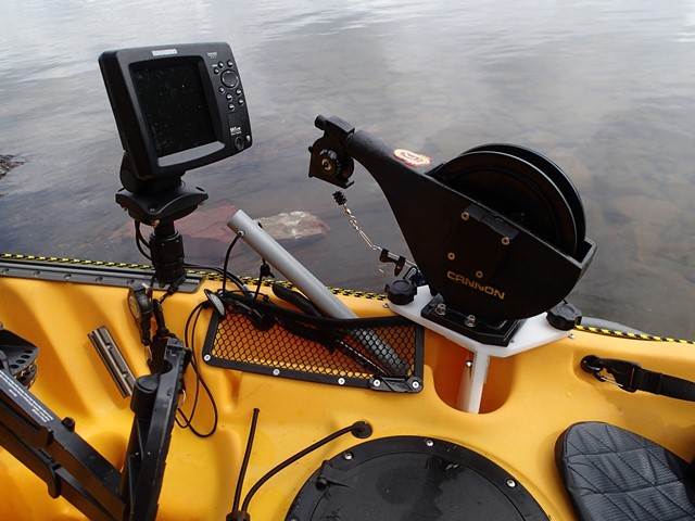

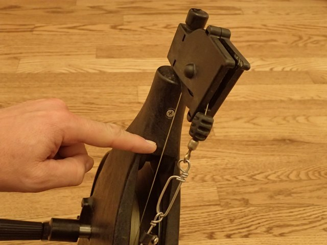

The first thing I did was shorten the boom on the downrigger, to make it easier to minimize the effect of the downrigger on my kayak’s tracking by positioning the cable only an inch or so from the side of my kayak, to make it easier to reach my downrigger's weight and release, and to minimize the stress which the downrigger places on the hull of my kayak.  It only took a couple of minutes to shorten the boom.  I removed the screw which holds the boom in place, pulled the boom out of the body of the downrigger, sawed off most of the boom, stuck the boom back in the body, drilled a new hole in the boom, and screwed the boom to the downrigger's body.
The only other change I needed to make to the downrigger in order to shorten the boom was to deepen the throat of the downrigger slightly so the cable doesn’t rub on the throat.
The Cannon downrigger has a base for a rod holder on the back of the body of the downrigger.  Because the rod holder base isn’t oriented in a direction which is useful, due to the direction the downrigger points when mounted on my kayak, I sawed the base off the downrigger.

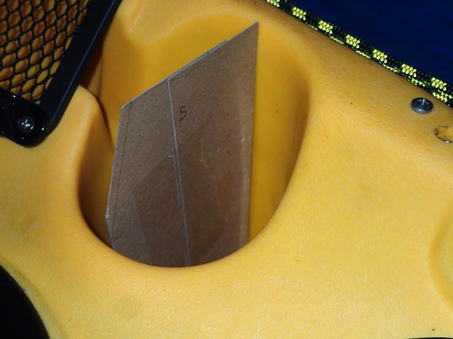

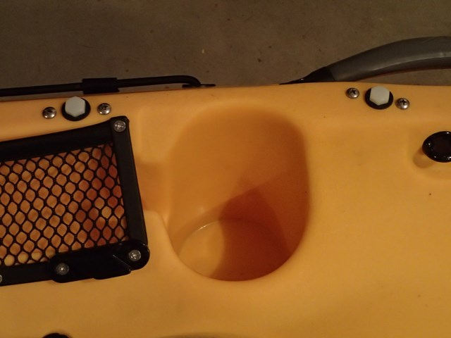

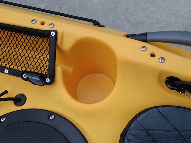

It’s difficult to mount a downrigger on the gunwale of a Revolution, because there aren’t any large flat spots on which a downrigger base can be mounted.  It would be much easier to mount a downrigger on the gunwale of a Hobie Outback or various other kayaks.  I figured out how to mount a downrigger base on the gunwale of a Revolution by mounting two sealed nuts inside the right gunwale of the kayak, and then stabilizing the mount against rocking in and out by making a plug which fits inside the kayak's water bottle holder.  the picture below shows how I made the sealed nuts.
The picture below shows where the nuts are located on my Revolution.  An easier way to attach a downrigger mount to the gunwale of a kayak is with a section of track.  On my next kayak (?!) I’ll use a piece of track to attach the downrigger base.  I suggest a way to make devices which mount on gear tracks in a posting at http://www.northwestkayakanglers.com/index.php?topic=13167.msg144750#msg144750 .
The nut assembly is sealed pretty well, but to further protect my kayak against leakage when I’m not using the downrigger, I screw nylon nuts with rubber gaskets into the nuts, as shown below:

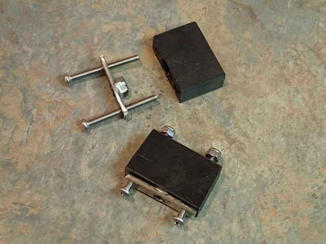

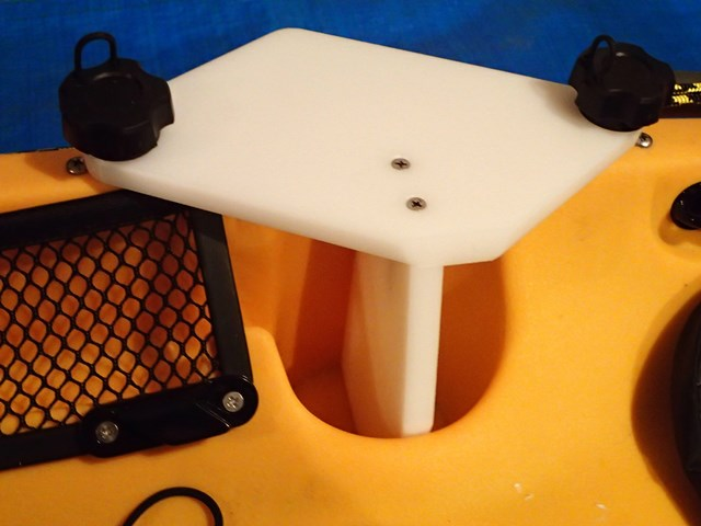

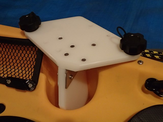

The mount for the downrigger is constructed out of high density polyethylene (HDPE), which is the opaque white plastic used for cutting boards.  One brand name for this plastic is “Starboard.”  This plastic is readily available where I live, and I picked up some appropriate sized scraps for a few bucks.  I would have preferred to use ultra high molecular weight polyethylene (UHMW), but that kind of plastic is hard to obtain in my area.
The nuts mounted in the gunwale of my kayak keep the downrigger attached to the kayak, but don’t keep it from rocking from side to side on the gunwale.  To prevent the base from rocking from side to side, I constructed a flat plug which sits in the Revolution’s water bottle holder at right angles to the gunwale.  I determined the dimensions of the flat plug by making a template out of two pieces of cardboard taped together.
I bolted a piece of cardboard on the gunwale of my kayak, sat the shortened downrigger on the cardboard, and then positioned it where it was out of the way of my thigh, was easy to operate, and would place its cable about an inch from the side of my kayak.  I marked the location of the downrigger on the cardboard, and then cut out a template out of the cardboard for the top plate.  I used the two templates to cut the top plate and the plug out of HDPE, inserted the plug in the water bottle holder, bolted the top plate to the gunwale on top of the plug, and then drilled holes in the two pieces and screwed them together with two stainless steel screws.

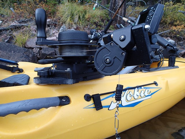

Then I cut braces out of aluminum angle stock and bolted them to the plastic with stainless steel bolts and locking nuts.

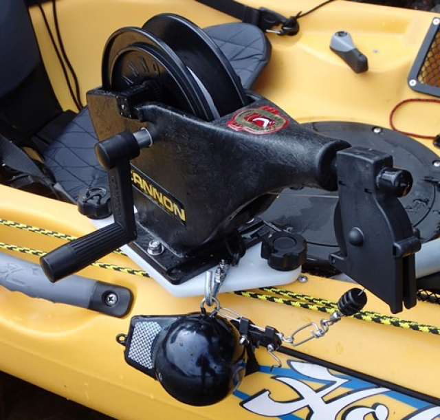

Then I bolted the downrigger to the base with stainless steel bolts and lock nuts, as shown in the three pictures at the beginning of this posting.  I decided not to use the slide-in base which comes with the downrigger because it’s pretty big.  But the next time I make a downrigger base I'll use the slide-in base, because there are times when it is nice to be able to take a downrigger off or put it on its base quickly when you're on the water, such as when going in and out through surf.
I added a hook to the downrigger’s base for the weight, so when the weight is hanging from the pulley it won’t drag in the water or bang against the side of my kayak when the kayak rocks in waves. If you replace the steel cable which comes with the downrigger with braided downrigger line to eliminate cable hum and to reduce drag, when you're transporting the downrigger the braided line can come out of the notch in the pulley wheel and get stuck between the pulley wheel and the side of the pulley, and the only way to get it back into the notch is to cut off the weight, feed the braided line through the pulley with a piece of wire or pipe cleaner, and retie the braided line to the weight.  This is an irritating hassle.  To prevent the braided line from getting stuck, when I'm transporting the downrigger I hang the weight on the hook and keep the braided line under tension.

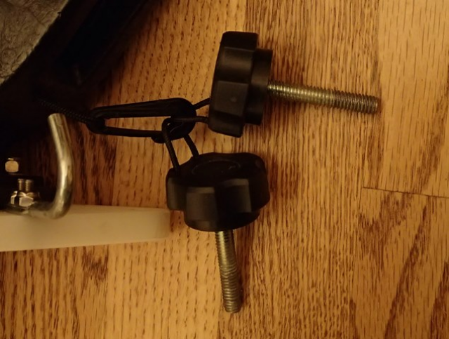

So I won’t lose the bolts which attach the base to the gunwale, I put loops of cord on the handles of the bolts, and as soon as I take the downrigger off my kayak, I clip the bolts to the downrigger.
I made the mount using hand tools.  For example, I cut the pieces of plastic with a crosscut wood saw, I dressed the pieces with a wood plane, and I drilled the holes with a hand drill.  If you have fancier shop equipment and machining, woodworking, and/or welding skills, you should be able to come up with a mount which is nicer than mine.
The base is very stable, and doesn’t rock or flex at all when I turn the crank of the downrigger.  I’ve used the downrigger extensively since the winter of 2014, and am very happy with the entire setup.

The line counter didn't work.  Its gears must have been sized for a Cannon downrigger with a different size cable reel, because the reading shown on the line counter was completely different from the depth of the downrigger weight shown on my fish finder.  Which is too bad, because an accurate line counter can be useful on a downrigger.
You can't switch the Cannon Lake-Troll's crank handle to the other side of the casing.  But you could mount the downrigger on the left side of your kayak with its boom facing backwards.  That should work fine, if there is a place on the left gunwale of your kayak where the downrigger can be mounted. What kind of kayak do you have?
