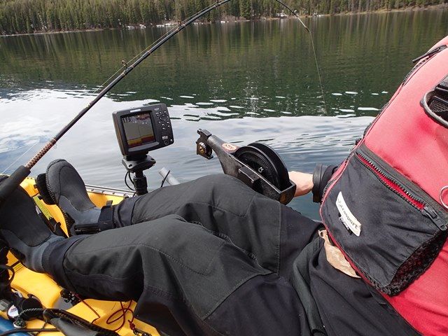

I’ve used both a Scotty Depthmaster downrigger and a Cannon Lake-Troll downrigger on my 13” Revolution.  I’m writing to compare the advantages and disadvantages of these two downriggers.  The bottom line is that they both work well on a kayak, but I’d give the Lake-Troll a slight edge over the Depthmaster.
Here’s how I mounted a Scotty Depthmaster on my Revolution.  This mount is described at http://www.northwestkayakanglers.com/index.php?topic=11954.0 .

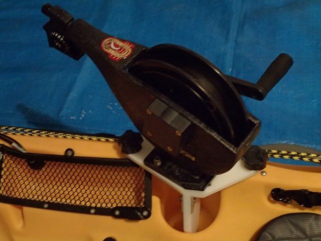

Here’s how I mounted a Cannon Lake-Troll on my Revolution.  This mount is described at http://www.northwestkayakanglers.com/index.php?topic=12575.0 .
Here’s how I think these two downriggers compare, issue by issue:
Overall size.  The two downriggers take up roughly the same amount of space.  The Depthmaster has a horizontal cable reel, and the downrigger's body is low and wide, while the Lake-Troll’s cable reel is mounted vertically, i.e. on edge, and the downrigger's body is high and narrow.  However, the handle of the Depthmaster sticks up 8 3/8", which is exactly as high as the cable reel sticks up on the Lake-Troll, and the handle of the Lake-Troll sticks out to the side of the body of the downrigger.  The Depthmaster might fit better in one location on your kayak, and the Lake-Troll might fit better on a different location on your kayak.  With respect to overall size, I think these two downriggers are about the same, but which will work better for you depends on where you want to mount it on your kayak.
Base style and size.  The bases of these two downriggers are very similar in size and style.
Ease of cranking.  It’s easy to crank up a six-pound weight with both of these downriggers.  When the downriggers are mounted next to my right thigh, I think it’s somewhat easier to crank up the weight with the Lake-Troll, but in another location on my kayak, it might be easier to crank up the weight with the Depthmaster.  With respect to ease of cranking up the weight, these two downriggers are pretty similar, but I think the Lake-troll is slightly easier.
Brake.  The Depthmaster’s brake is operated with a lever.  When you engage the brake, it stops the cable reel instantly.  However, when you release the brake, the weight goes into free fall.  It’s an all or nothing deal.  I can’t feather the brake to let the weight descend gradually.  To control the descent of the weight, I need to hold my thumb against the inside of the cable reel.  The Lake-Troll’s brake or clutch is operated by the crank.  To raise the weight, you turn the crank clockwise.  To lower the weight, you turn the crank counter-clockwise until the clutch releases.  You can control the descent of the weight precisely by feathering the crank.  To stop the weight, you turn the crank clockwise until the brake or clutch engages.  I think the Lake-Troll’s brake is better than the Depthmaster’s brake.
One hand operation.  Both of these downriggers can be easily operated with one hand.  However, with the Lake-Troll you only need to operate the crank in order to raise and lower the weight, but with the Depthmaster you need to move between the crank and the brake in order to raise and lower the weight.  I think the Lake-Troll is a little easier to operate with one hand than the Depthmaster.
Shortening the boom.  I like to shorten the boom of my downriggers, so they don’t take up so much space, so the pulley and the cable will be located only an inch or so away from the side of my kayak, and so the downrigger doesn’t put as much stress on the hull of the kayak.  Shortening the boom on the Lake-Troll is a ten minute project, because when you shorten the boom the pulley continues to feed the cable into the center of the cable reel.  Shortening the boom on the Depthmaster is a big project, because when you shorten the boom the pulley ends up below the level of the cable reel, and the cable will run against the edge of the cable reel and be bent at a sharp angle.  Raising the pulley so it continues to feed the cable into the center of the cable reel, or adding a device which re-directs the cable into the center of the cable reel, requires a lot of creativity, do-it-yourself skills, and work.  It’s way easier to shorten the boom of the Lake-Troll than it is to shorten the boom of the Depthmaster.
Pulley.  I have a steel cable on my Depthmaster, and the pulley works fine.  I have 175 pound braided low-drag Spectra line on my Lake-Troll, and the line has come off the pulley wheel and jammed against the side of the pulley several times, usually when I’m transporting the downrigger.  I don’t know if this wouldn’t happen if I was using steel cable on the Lake-Troll, and I don’t know if it would happen if I had braided line on my Depthmaster.  But I know that when the braided line gets off the pulley wheel of the Lake-Troll, it’s a pain in the ass.  The only way I have been able to get the line back into the pulley wheel is by cutting off the clip at the end of the line, feeding the line through the pulley, and tying the clip back onto the line.  This is irritating and wastes time.  I've been able to keep the braided line from getting jammed next to the pulley wheel of the Lake-Troll by hanging my weight on the hook on the downrigger's base when I'm transporting the downrigger, and keeping the braided line under tension so it stays in the pulley wheel.
Line meter.  The three-digit line meter on the Depthmaster is quite accurate, and agrees closely with my fish finder.  I find the line meter pretty useful.  On the Lake-Troll, the circular depth meter on the pulley is quite inaccurate.  I ordered a three-digit line meter from Cannon and installed it.  Unfortunately, it’s also pretty inaccurate.  I don’t know if this is because I’m using braided line rather than steel cable, or if it’s because the line meter was designed for a different model of Cannon downrigger.
The bottom line.  Overall, the Scotty Depthmaster and the Cannon Lake-Troll are pretty similar in size and ease of operation.  The Lake-Troll has a better brake, and is a little easier to operate with one hand.  The Depthmaster has a better line meter and a better pulley.  I find that I prefer to use the Cannon Lake-Troll, but which downrigger works better for you will depend in part on where you mount it on your kayak.  If you want to shorten the boom of your downrigger, definitely go with the Cannon Lake-Troll, as it’s much easier to shorten the boom of that downrigger.
